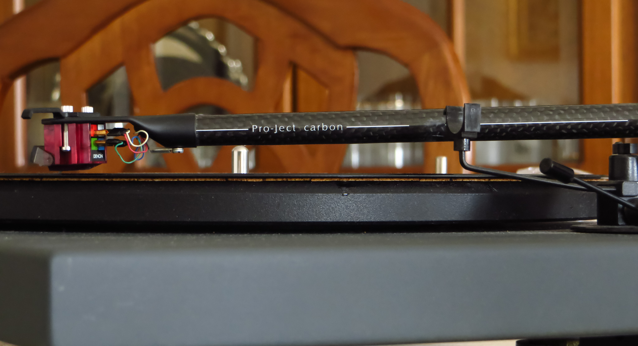

A while ago I ordered one of those inexpensive digital scales, and it arrived yesterday. Today I measured the VTF, and it was a bit high. It's supposed to be 1.5g +/-0.3, but it measured 1.95. I turned it down a bit to around 1.6g (I'm still using the spring in the RB300, maybe I'll try the counterweight-only method too). I haven't had a chance to listen since changing the VTF. I need to get one of those test records; maybe my local shop (Taz Records : Atlantic Canada's Largest Music Store) carries them, or maybe I'll have to order on-line.
Here's a quick question about use of those little digital scales. (I got this one.) I think the tray is magnetic, by which I mean is affected by magnets. So I set it on the platter and it reads 0, then I swing the tonearm over so the cartridge is just above it but not touching, and the display reads negative (like -0.04g or something). So I assume the magnet in the cart is pulling the tray upwards. Now: how does that effect the reading when I lower the stylus onto the platform? Will it still read low? Will it read a bit high because the tray is attracting the cartridge, pulling it down? Or, since it is pulling the cart to the tray, but not to the surface below the tray, might it have no effect? I have decided to use a block of melamine foam ("Magic Eraser") to keep the cartridge body away from the tray, and clean the stylus at the same time!
You also had a mechanical scale before or you were only based on the RB300 indication? That digital scale should be much more accurate than what the arm roughly suggests and expect a big change in sound if you were +0.45g heavy indeed. Not just heavy but beyond max spec heavy.

Yeah, I was just using the Rega's dial, thought I had it at about 1.75. So you can see why I want to listen more before messing with C2y.
Sure, it will be the first time you will listen to it properly actually. By the way I just read the reviews on that scale and all 13 were written by turntable users stating it does the job perfectly so if its something lost in the magnetic thing it should be tiny. On the other hand if the arm will stand much tilting back due to some buffer distance material to avoid the magnetic pull idea, it will exert less pressure at the tip than with its front end normally set nearer to the plane of the record, will it not?

Today i think im going to adjust the VTA of the tonearm which seems to me , to be way off
Definitely nose down tilting. Exaggerates HF and THD due to wrong rake angle. Kyknos (swan) ketchup is a classic.

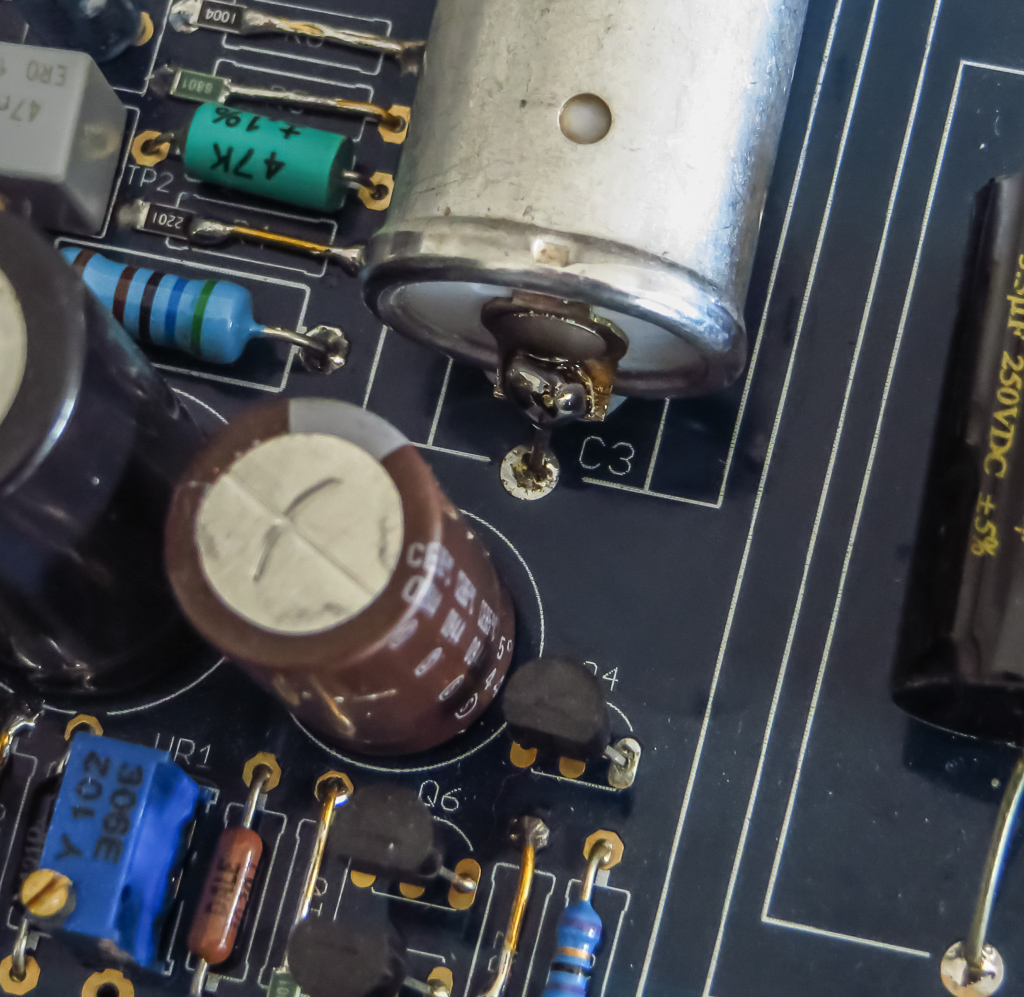

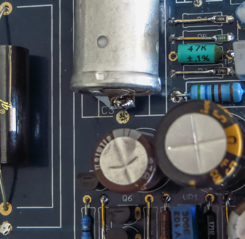

I used 3 different caps in c3: philips axial polystyrene, obbligatto copper and the latest ft-2 teflon. Different presentation for each. The philips polystyrene was neutral , obbligatto was "warmer" and FT2 has the best resolution out of the rest but is also pleasant. I prefer FT2 but could also live happily with the rest as well
Only point of attention, if used in high gain setting builds, bcs their metal jackets are floating they may attract hum. But attaching a wire from their barrel to some handy GND node, largely solves it. In no case any conductive jacket cap should be allowed touching unused pads underneath it let's remind to any prospective users by the way.
Yes, i remembered that you were saying that these caps might collect hum. I checked and fortunately there is none present
You got 43dB which is safe. If you touch them when the volume is cranked up can you hear some little hum for instance? That's only an experiment of course, what matters is they are not adding hum normally. Not even touching maybe is audible before LMC mode gain. My PTG/II puts out less than 0.25mV across 200 Ohm on the 5cm/sec Telarc Omnidisc 0dB ref track for instance. I use 20dB more gain on 94dB/W speakers. Imagine how any susceptibility becomes much more of a sudden problem.
