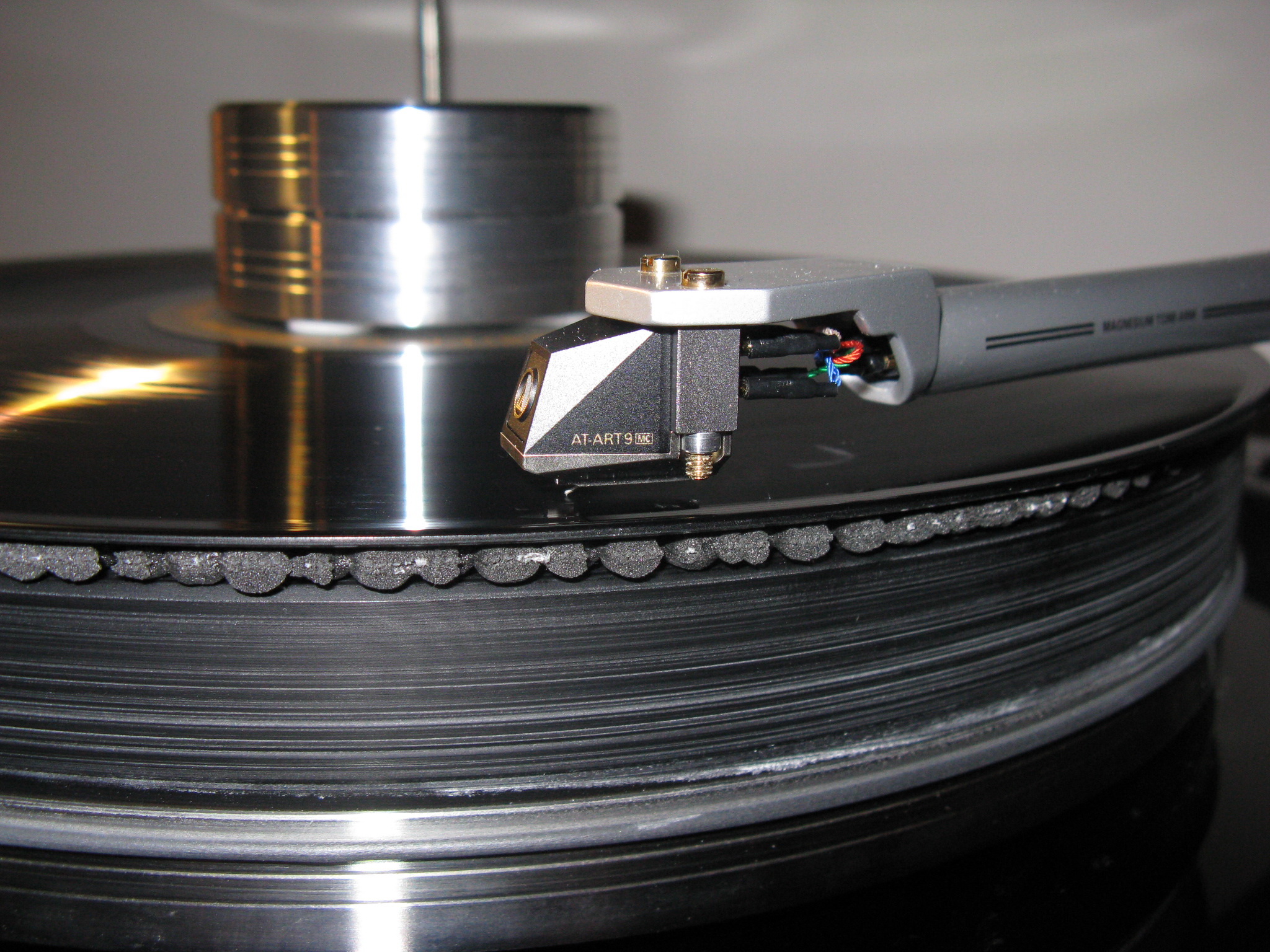

After my Shelter had a suspension damage, had to do something, as my Denon 103 I had for backup was nice but something was missing.
So here it is an Audio Technica AT-ART9.
I think that I took a little bit of risk as not so may around to get a meaningful feedback, but went for it.
Only a few hours so far, but really satisfied. In fact is the best cart I heard so far, including a few Lyras from the past. It surely needs some hours first before making final conclusions, but so far I think it' s among the top ones. Most probably you need much more money to even or better it.

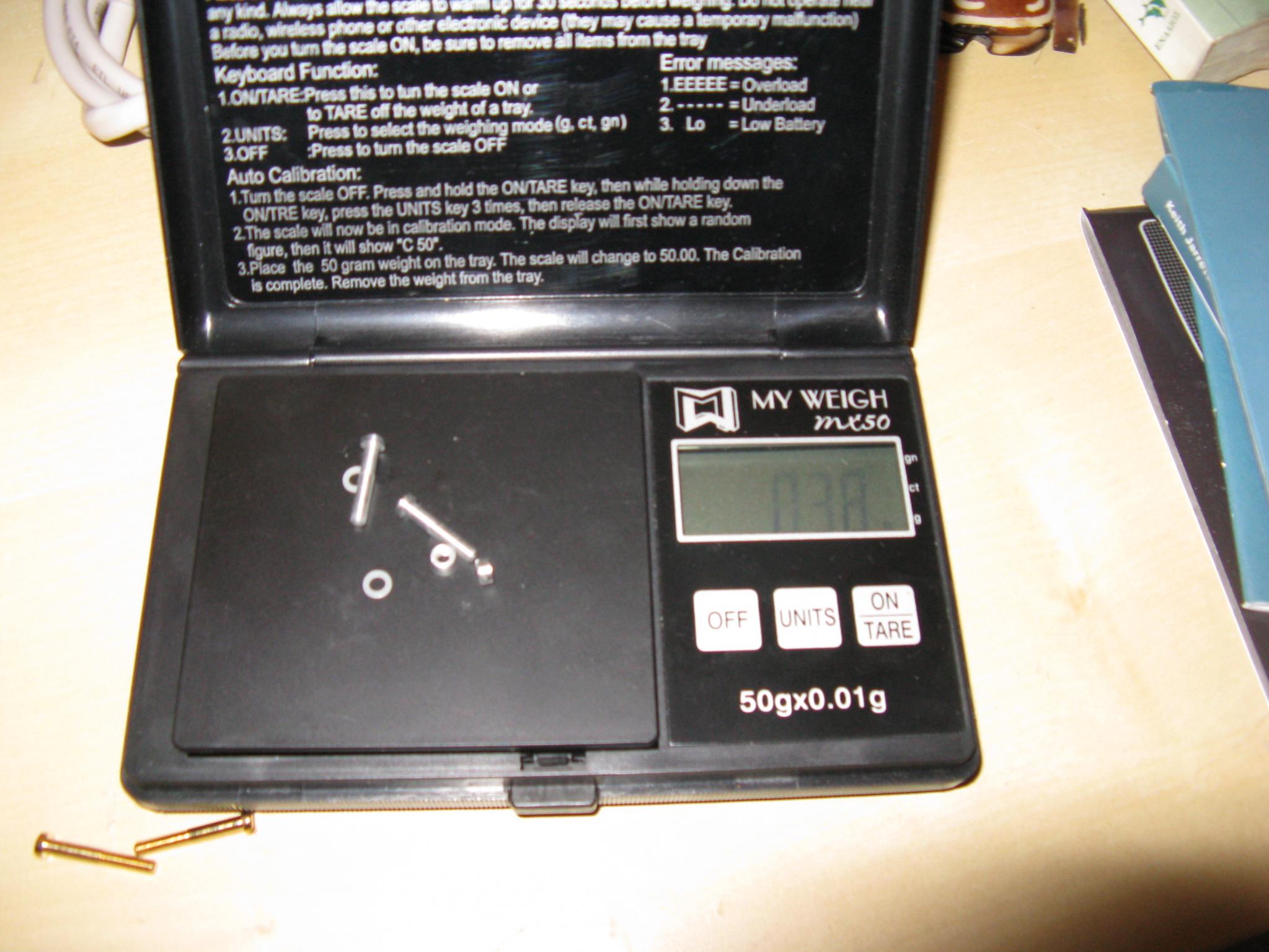

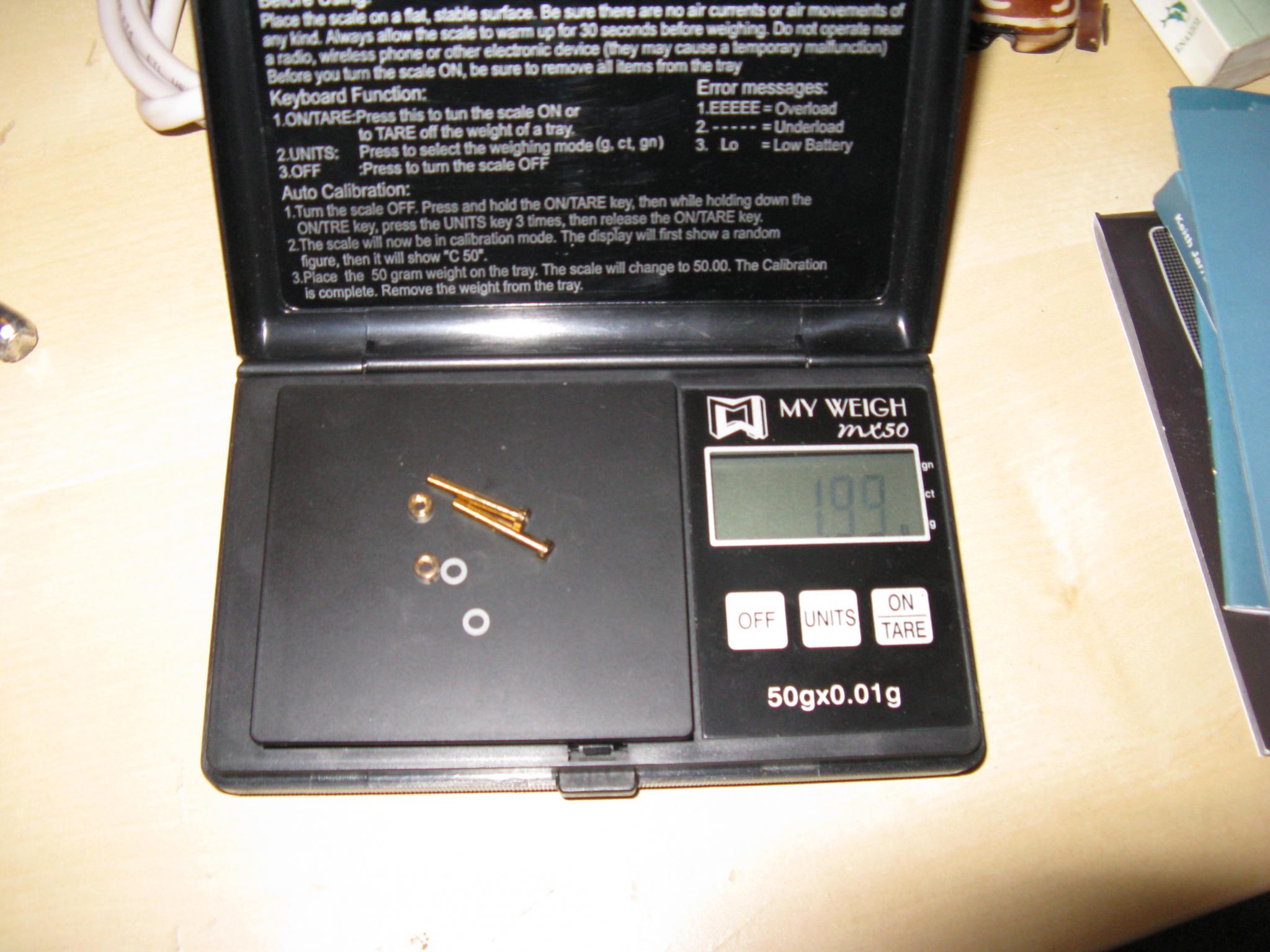

Congrats. Looks excellent on the SME for color scheme too. You could cut off the screws excess length at a point I think. 3 turns shorter or so.
I had no other screws that fitted except the ones with the cart. All the other ones were shorter. Will find something that fits the silver color too😉
Those are excellent quality brass screws that were in my AT's jewel box too. They are bit heavy but Audio-Technica claims they play a role for a controlled mounting regarding vibrations travel. Me I could not use them because my shell is blind on top and they are longer than fitting it correctly. Try Alu because ART9 is more compliant than 33 PTG/II and the SME is medium mass. Shaving off a bit of moving mass anywhere possible is even better.
I will test the resonance frequency of the 33+774 (11gr modded) again now that it seems like breaking in. It was 9Hz initially. Those carts are very demanding on setting them right. The sound has already taken on a massive bubble around and behind the speakers with deep bass and thick power range. Very 3D. Smooth also so I may re-evaluate the max allowable loading value for gaining max resolution before thinning out. But its a matter of tonal synergy with the line preamp too.
