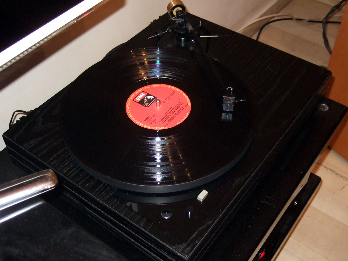

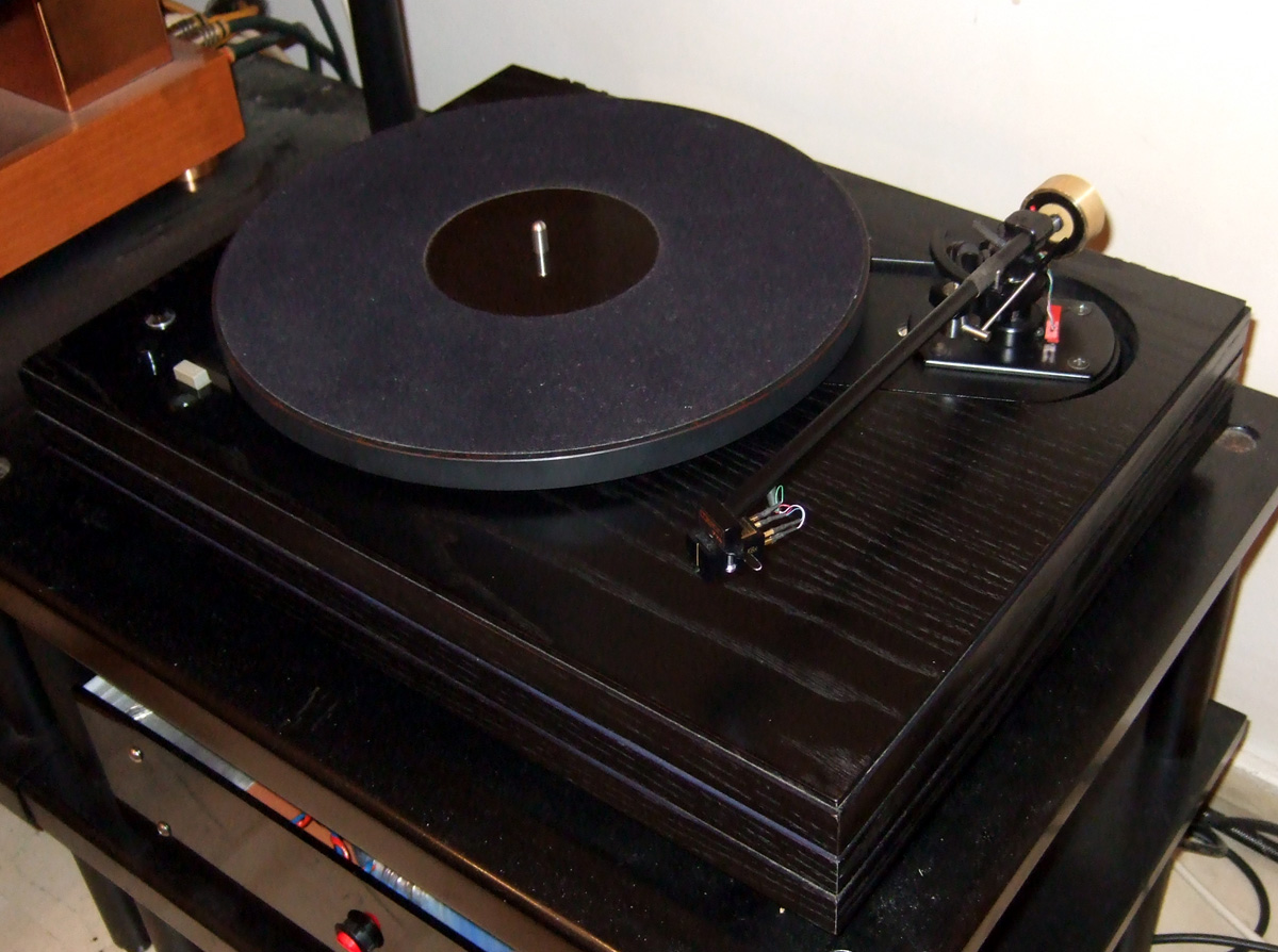

The now mutant other TT is coming home today so I hope all operations went well. 33/45 buttons added even. 😉

Some pics?
Listened to few tracks only as it came back home just an hour ago. But here you are, fast photo break 4U:

The 774 is a medium mass arm now, wand stuffed with 6.5g silicone, also got a coax gold hue brass counterweight addition. The Cardas wiring got its grounding scheme reworked. The CJ58 deck has mutated to a DC motor TT now with double decoupled aluminum motor base, plexiglass plinth base, Corian feet, balance weight across the arm at the sub-chassis for the springs to float better, it feels two times heavier as a unit after those things. Even got 33/45 speed controls. Thanks to my expert friend Mike.
The one with the Dyna 10x HOMC is going to play through the Itch to bypass SUT influence and I will remeasure/ponder on the valve unit, if I extract more performance I will let you know Mr. Mago some time later in the VI thread. Now the mutant TT on FS phono plays perfect pitch and resolution is way up so I will have fun for a while before thinking Itch revisited scrutiny.🙂

What sort of DC motor installed?
Pull out from an old made in Korea TT. Along with its control and servo electronics. Works fine. Has a faded marking at the motor's back that reminds the Mitsubishi logo.
