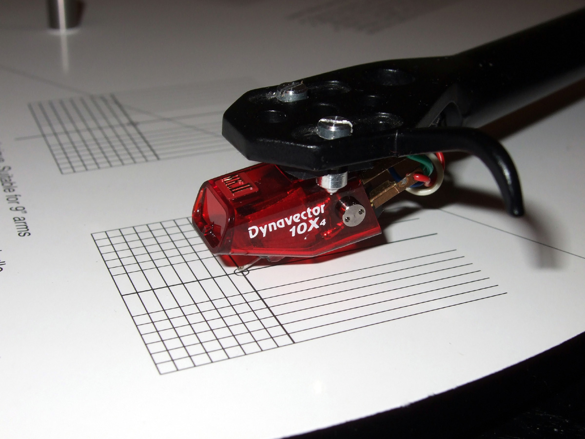

I have the Systemdek IIX900 with RB300 as spare for now in case something goes wrong with the mutated Walker. I will fit it a Dyna 10X4 MKII as good as new that I also got and use a Valve Itch on it or something.
