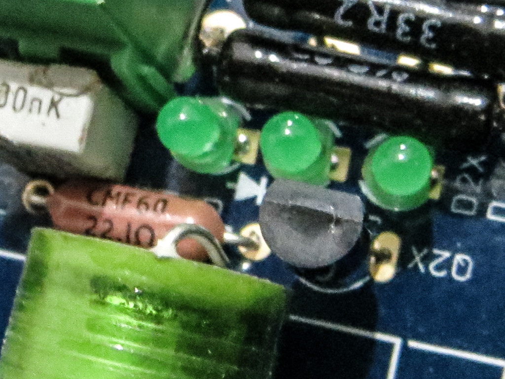

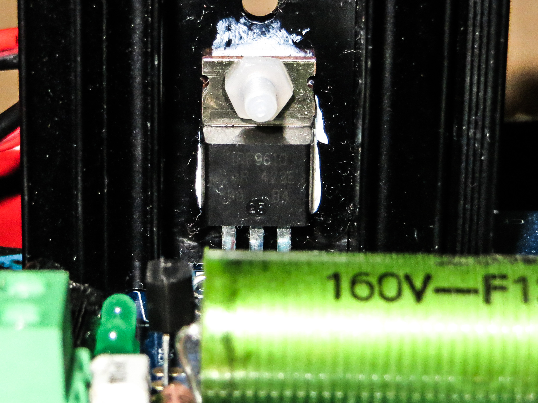

Its irf9610

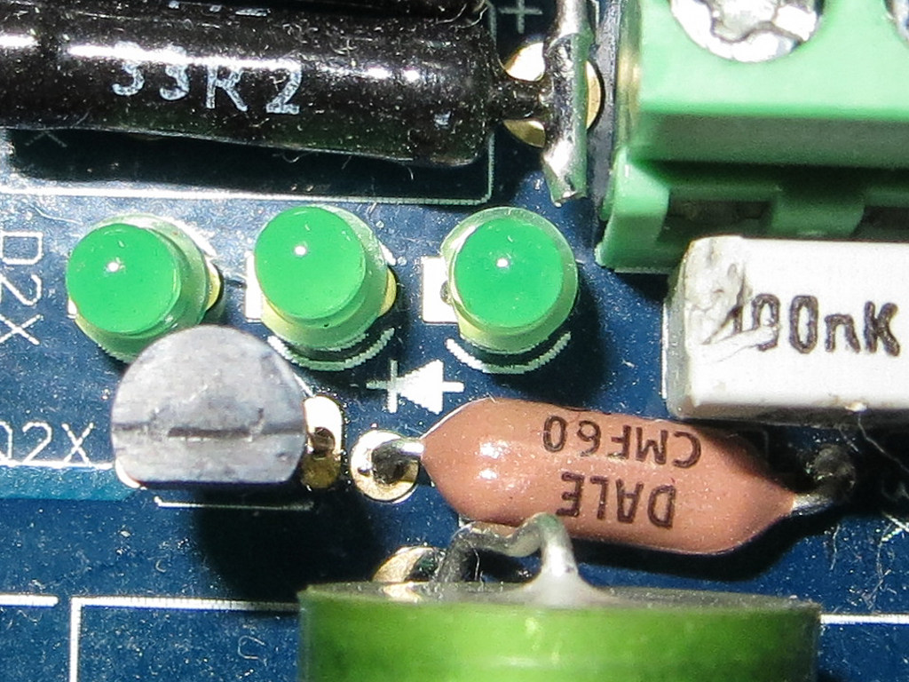

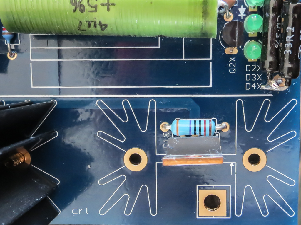

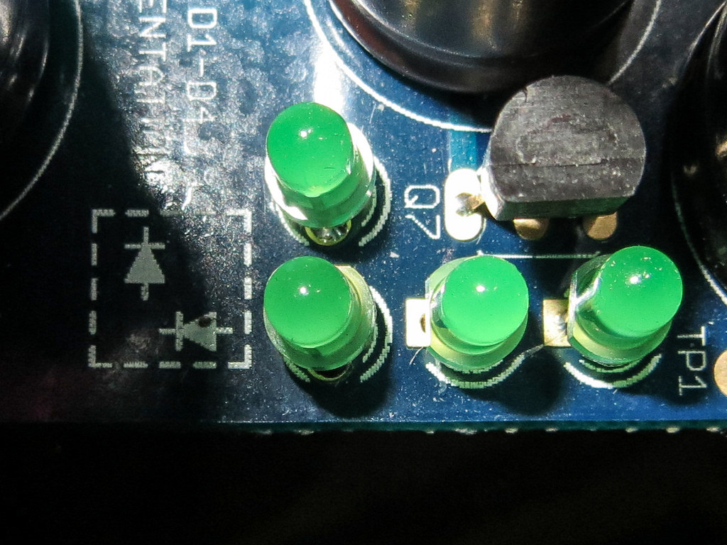

So we went through the whole CCS circuit by now. D2X,D3X,D4X you said all light up on individual test and they have cathode on square pad, R1x you restored to typical value, Q1X is 9610 indeed, R6x is 22R indeed, Q2X can't be wrong on both channels, slim chance. This IS weird. Double check the LEDS for a last time.
OK stop for now its late. Tomorrow recheck with a clear head. Its very weird but there should be an explanation. Something with the sinks maybe. Being scratched and having scratched solder mask also? Chasing a ghost. We will find it.
I'm sure Salas will walk you through all this tomorrow, but clearly there is no current passing through R1x (else there would be voltage drop across it) nor through the LED's, hence through Q2x. I would start by isolating the LED circuit by lifting one end of R1x and R2x. If the LED's don't light then either one of the LED's is bad, or Q2x isn't conducting, or R6x is open. You already measured R6x, and we already know there is 49V at the junction of R1x and the diodes. Ergo, if the diodes are OK and R6x is OK, then the ONLY other thing is Q2x, and it is either bad (as Salas said, unlikely on both sides) or the wrong part or installed incorrectly. Either way, Q1x is not going to conduct until Q2x does.

My biggest concern and question is related to LEDs again....
I'm sure that my 4 LEDs (D1...4) are matched between L and R channels, but I hesitate about 7.75v setup. As you did see, I installed 2 red and 2 green LEDs and theoretically I'm getting about 8v.

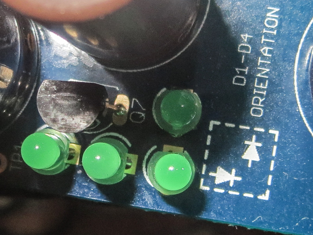

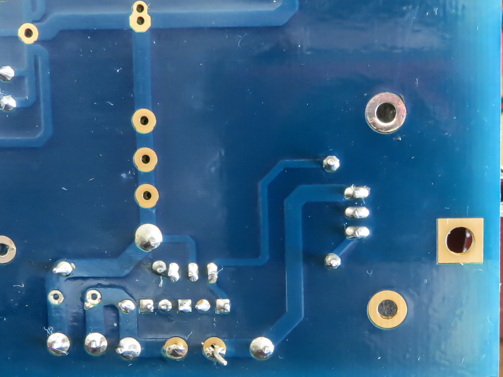

Q2x is the correct type and properly inserted.Posting some closeups for reference. Measured resistance between Drain and Source is 92-93 ohms in both channels. Going to remove heatsinks now

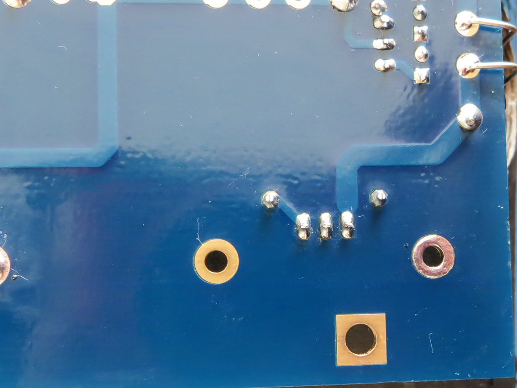

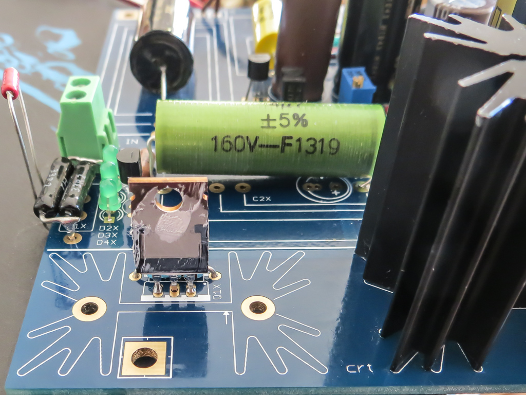

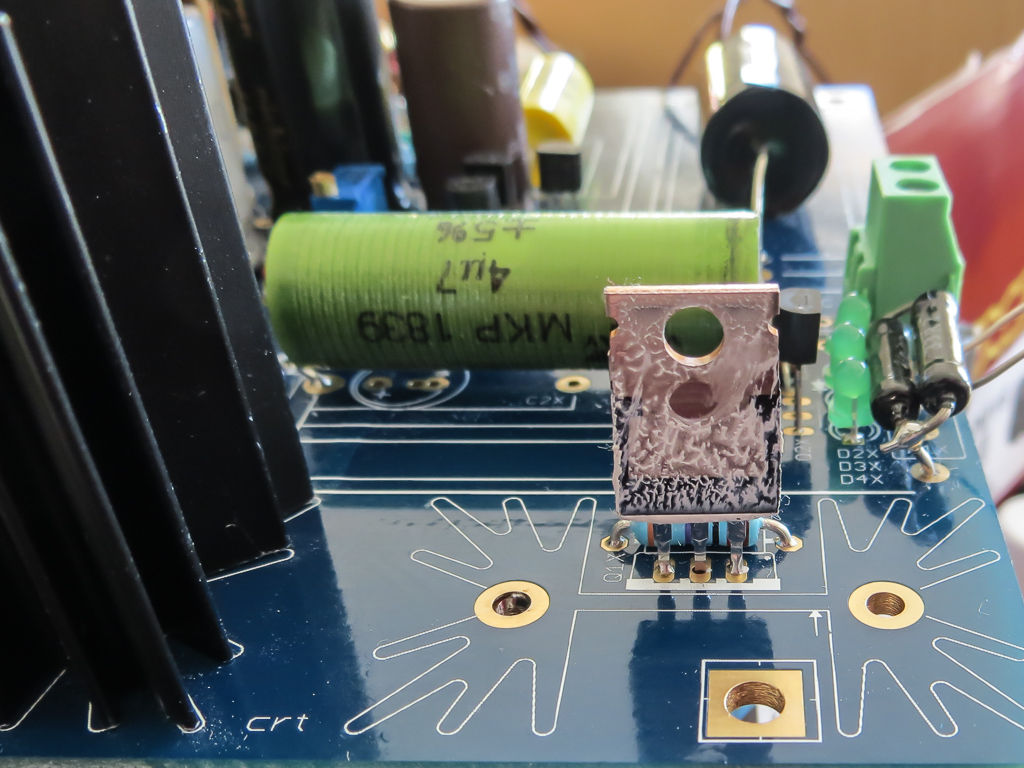

Good thing i only soldered one tab of the heatsinks, removing them was easy.
I dont see the soldermask been scratched anywhere.
Im going to re-heat the solder joints, hopefully that will solve the problem
