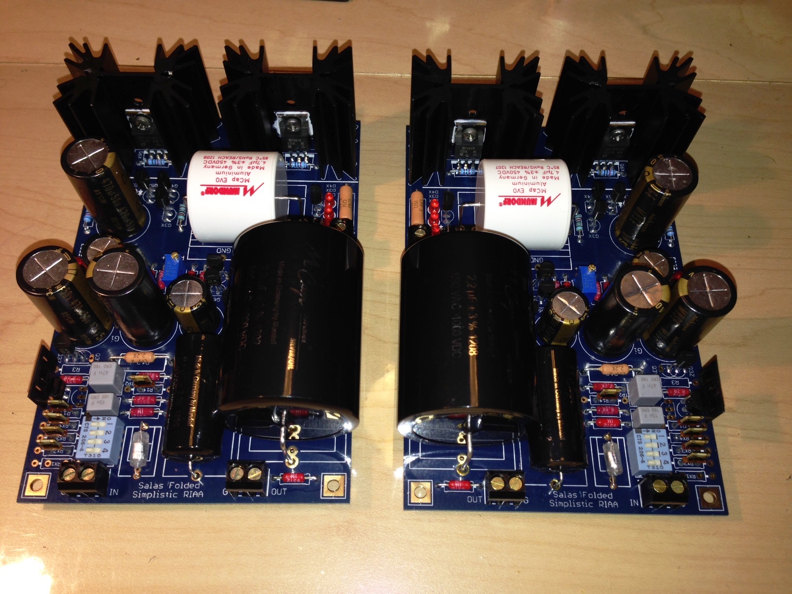

What kind R1, R14, C3, C4?
R1 and R14 are Vishay VAR, 100R and 47K respectively. C3 is Obligatto Premium Gold 0.1uF, C4 is Mundorf MCap ZN KP (?) polypropylene film and tin foil 2.2uF. (Both were on sale in the "bargain basement" at PartsConnexion.)
Mouser just got some Wima MKP4 4.7uF back in stock, so C2x will be those. I ordered a pair of Hammond 56VA 36V transformers. They were out of 470uF Nichicon KZ, so I ordered some FG's.
All parts are still on sale (20%) at Partscon till end of this month. I just received all missing parts and already installed them. 100R Vishay VAR is still on back-order and should have a pare in 2 weeks or so.
My C3 and C4, both, are Mundorf Supreme SIO.
I guess I can start testing without 100R load.

Looks very nice. Only those screw terminals for the inputs seem a bit inappropriate.
He has lots of tests to do because he does not know the real output of his cart, the company gives a vague spec over a huge range of loads. He may end up changing gain. So connectors come handy. He can solder wires directly in the end. Me I had no problems by using similar connectors in the proto BTW. They did not loosen till recently I checked.
Screw terminals are ok if you terminate the wires properly with Cable End Sleeves like those from WBT or others less expensive.
Just terminate the cables and screw them tight..
I'll take that under advisement; the ZN's were expensive enough! Meanwhile I think I'll build with what I have and see how it sounds. Your advice is always appreciated though.Mundorf MCap ZN replace with supreme IMHO. Not necessarily SIO.
They did when I bought them about a month ago. They had a few ZN's with short leads (not too short, but I assume they had been used) in their bargain basement; they were about $10/unit less.If the order was irreversible OK. Dry Supreme and ZN did not differ for price significantly on that vendor though.
