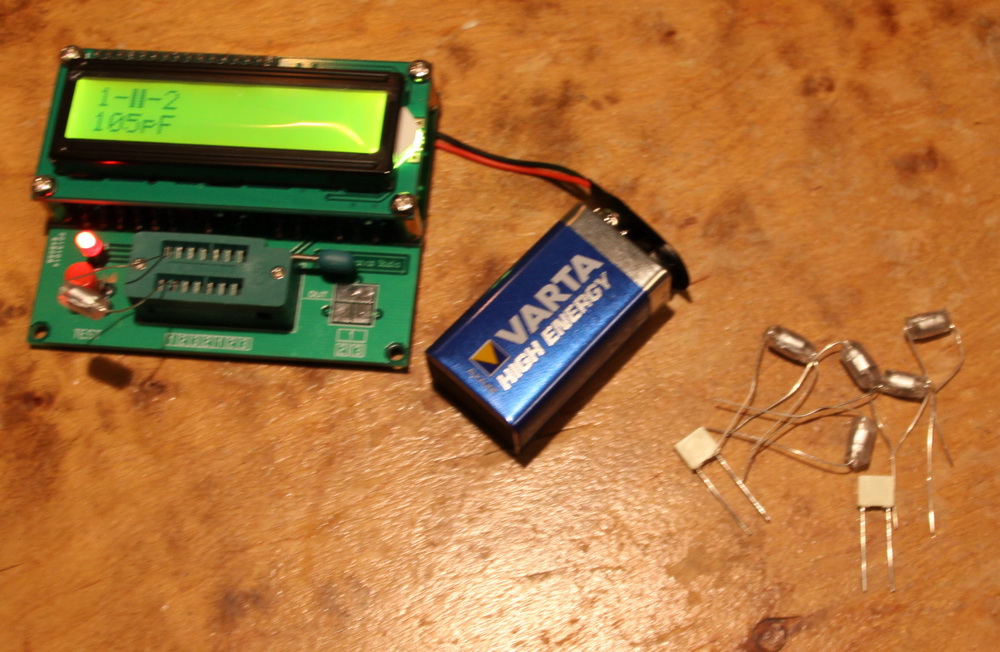

Got this from Saymlove 25 bucks
No % accuracy spec I see. At least you will know the components match between them. Absolute value remains to unknown spec. Maybe you could calibrate against a known accuracy LCR to discover its trends.
Yes its alright. What will be the cartridge?
I will be testing with modded denon 103. There is dynavector DVX1S waiting on the wing.
Quan
Doomsday prepping, in case of another GB
Yes China made @ 25$ is prob. not the best money can bay.
I thought about borrowing a LCR meter calibrated from job but with my long projects its nice to have one at home.
Will take the tester into work and test it up against a calibrated tester
