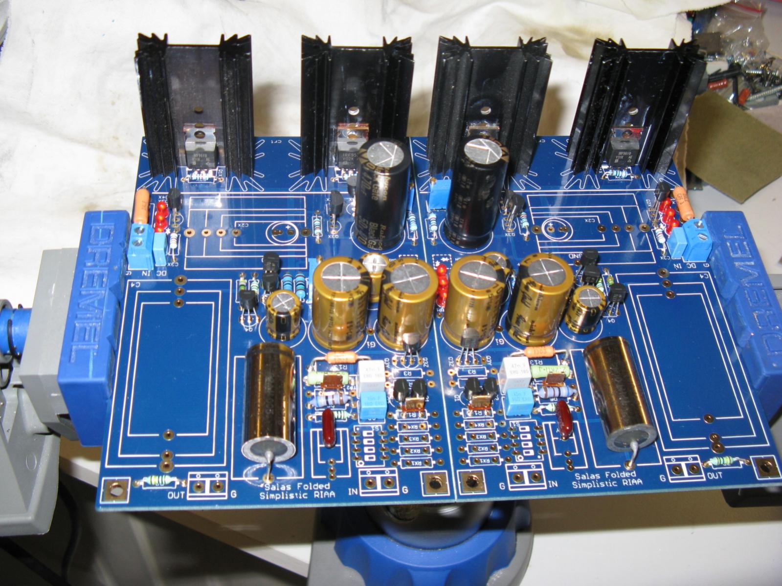

Some progress, still collecting parts. Not much are soldered as I will probably make some part substitutions.
Looking good. NOS USA Teflon even... Do those sinks have the needed mass for the output MOSFETs though? They are tall nonetheless.
P.S. See not to short any pads with the metal can C3s. Keep their barrels 1mm above board level.
