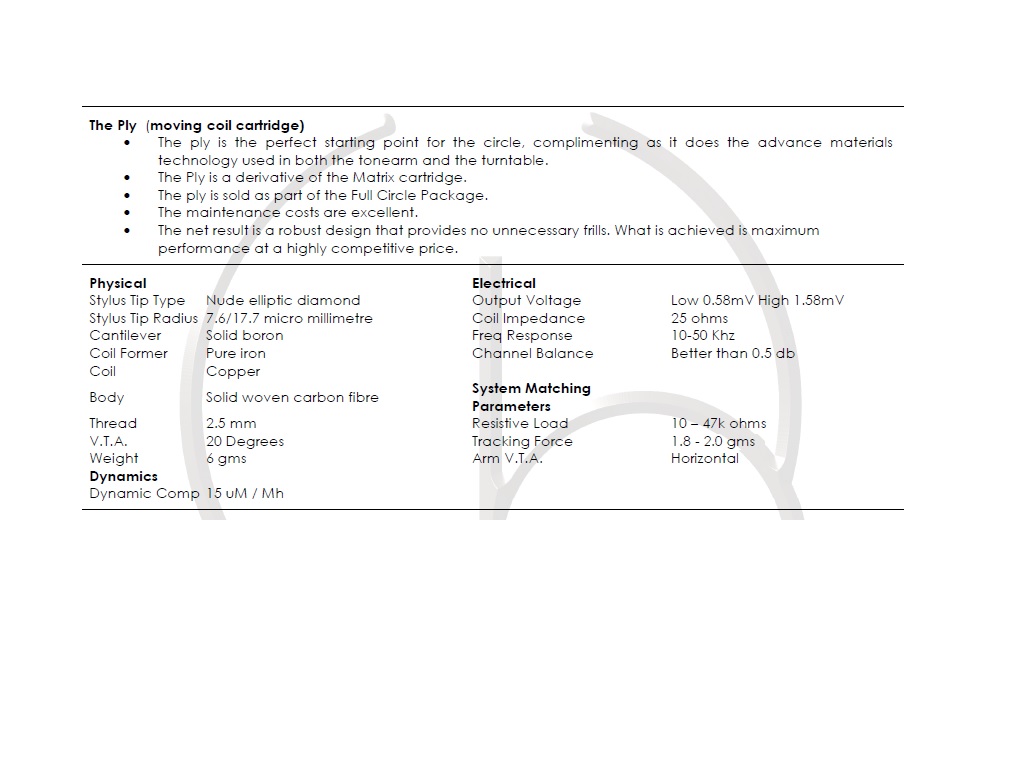

Ask your cart's manufacturer at what kind of load it gives about 1mV also. That XmV from XOhm to YKOhm reference is vague to say the list.

I sent them email. Lets see what will be the answer. I'm not sure if they know such details since Ply made by Benz Micro for them. I already asked such question Benz Micro about 3 month ago, but no reply. Please see attached picture taken from Full Circle TT documentation about that cartridge.
Are there two models in existence, one low and one high, or that spec is a range of output VS loading? Clear that with the manufacturer. Give them your S/N number to tell you which one you got if there are two models. Ask them at what resistive load it gives out 1mV if its one model. After you will know, if its a weird beast with a nowhere grouped output we can still devise resistor values for some intermediate gain in your phono. But we need concrete data.
It is a one module with the range of 0.58-1.5 mV. I asked them with my S/N when I purchased it. That I know for sure.
I sent them email today (to TT manufacture). Lets see what they will answer.
I do not know if make sense to ask Benz Micro again. They did not answer in the past.
They got precision lab instruments, they could run a test record with known velocity and test output for 3-4 load intervals.
They don't sell cheap USB sticks or cotton candy, they sell very expensive exclusive gear, they should be specific. I.e. press they will test for an answer.
