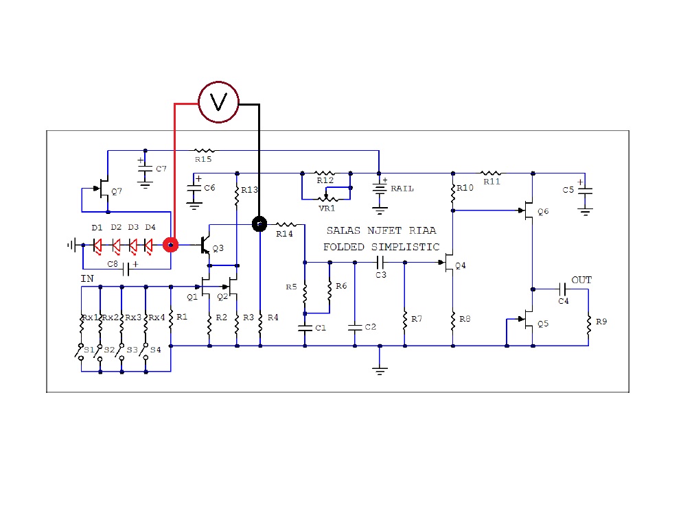

Hi Salas,
I have a couple questions about the setup from Folded manual:
1. What setup should I pick if my cartridge ("Ply" - made by Micro Benz for Wilson and Benesch TT) has 0.58mV - 1.58mV output with 10R-47K recommended load? It's in-between suggested in manual gain setup (from manual: 0.8-1mV and 2-2.5mV)?
2. What is TP1/TP2. Can't find such terminology. Are these points as I marked in my drawing (attached picture)?
3. I do you know if quad of 2SK369BL in mini-kit are matched? I got a quad of these as a kit from Mike. If not, I see the matching method recommendation in your BIB manual and it is easier than in Folded manual. No need to use any resistor. Can we use that simple method described via link in BIB manual for 2KS369BL and 2SK170BL?
4. 2SA970BL - I can see plenty of these on internet. It is make sense to get these since they are "much" better then BC560C?
Thank you

1. You should choose midway where it gives about 1mV and use the second option build setting circa 56dB gain phono. That should give good level and SNR.
2. Its test point 1&2. You probe across and you set V by following the guide steps for recommended readings.
3. From what I know Mike only offers a limited quantity of matched 369s. Else it would be of no use to send just four. It takes a whole batch to arrive at 2 or 4 well matched ones. You can use that method for any JFET type to check its IDSS, yes. Beware of accidental shorts that can blow your DMM mA fuse in that simpler method though.
4. 2SA970BL is better than BC560C for linearity, still not greatly better at the bias point used in the phono, it has 3 times less the internal resistance though, but half the HFE usually, and you could get a couple to listen to after you had listened with 560C and decide yourself if you can perceive a difference and what you prefer. Use the BC560C Fairchild that comes from a big vendor firstly anyway because you never know without a curve tracer and an original to compare if the Ebay 2SA970 will be a fake even.

Thank you. It's clear for me now. I did not put attention to PSB marks.

The photo in your link hints to original. More than that don't know. HFE much more than 400 in BL is unlikely to chance on though. Get some to compare, no harm. That is why I put the optional position for Japanese low noise types, for builders to have some fun. Don't forget to remove the 560s when you will do that. Its using either type alone, not both.
