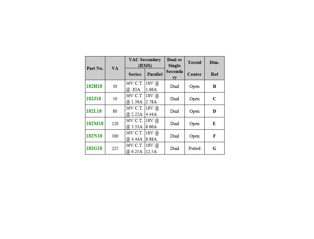

What toroid do I need to choose from Hammond list (attached). They do not have single 36v+36v, but they sale 18v dual (assume 18v-0-18v) that can be connected to single 36V with the verity of currents. I can use two transformers (one for each channel...).
Can you please mark P/N and I'll go to order these. Thank you.

IMO you should use at least two 80VA TX... one for each channel.
It seems too much, but the folded will really sing in the end.

Its a 18 + 18 (4 wires secondaries) global primaries series. So its flexible. 182H18 will do.
Not that economical a series though. Each one costs as much as an FSP stereo PCB.
I see your point about the budget and I agree that 1 toroid will be a more economically and ergonomically better option. The issue is: I cant find it so far on internet in US. I'll appreciate if you will direct me to some site as you did with EPCOS cap.
