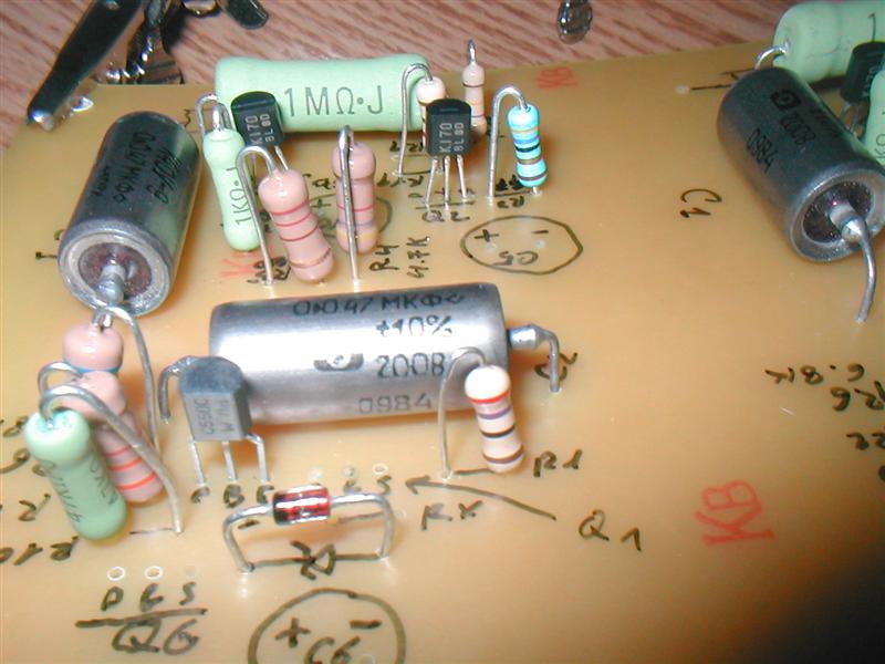

All resistors in place (had to deviate a little from Lee´s layout to acomodate the uge 1M kiwame).
Promising.....
Promising.....

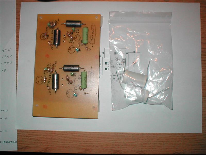

Got the k40y-9 PIO russian caps today, in the .15u value. They're burning in 😀

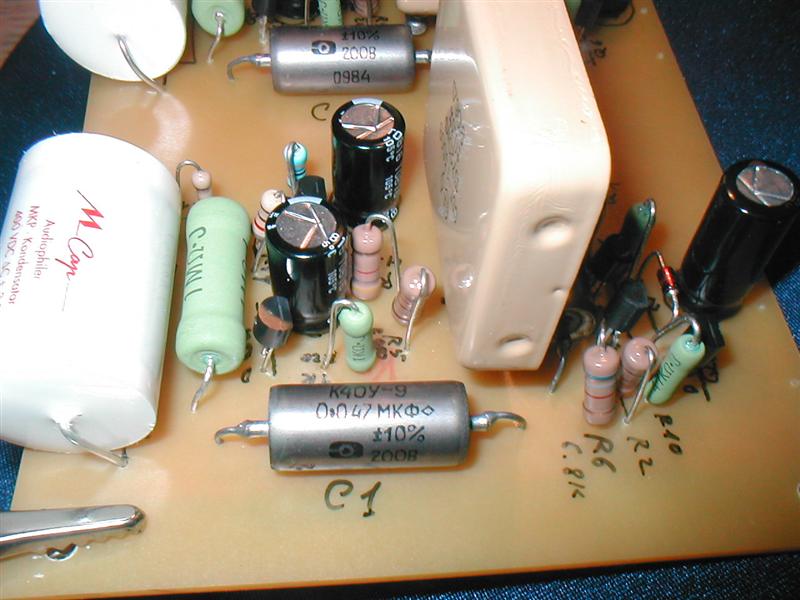

What value are you using for C1 ?
I have a russian k40-9 0.047 there but looking at the photos previously posted, these seems so small
Ricardo
If you mean that one after the RIAA that goes to the 1meg to earth and second JFET's gate, then 47nF to 150nF will do. Center is 100nF. The response will still go subsonic with all of the above. No problem.
Ricardo, I put a .15u russian cap in the interstage coupling position, and then another one on the output, in parallel with two 1u (sprague pio).
Hope it goes well for you.

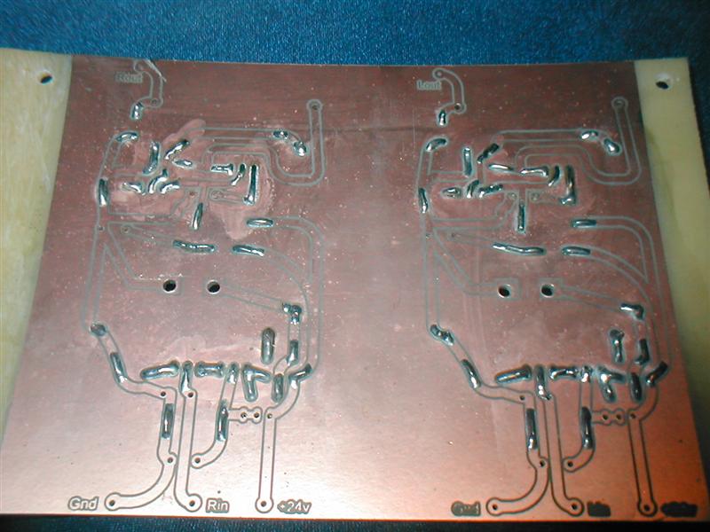

After all the board does not have a common GND between channels.... Lee left the copper all around the circuit... like a mask... should I ground this "virtual gnd" ?

Actual ground traces I would connect from phono channels to the shunt's reg out GND like a Y. And from there, with one cable to chassis. The masks I would connect locally to the ground traces where the cables to reg GND take off. Off course all this may change if you face some GND loop (I wish not).

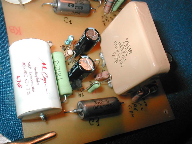

I hope that the PIO in the RIAA filter is in good tolerance...
Where is your C3? This one is the most RIAA critical. Must be 15.8nF-16nF measured and matched if possible.
