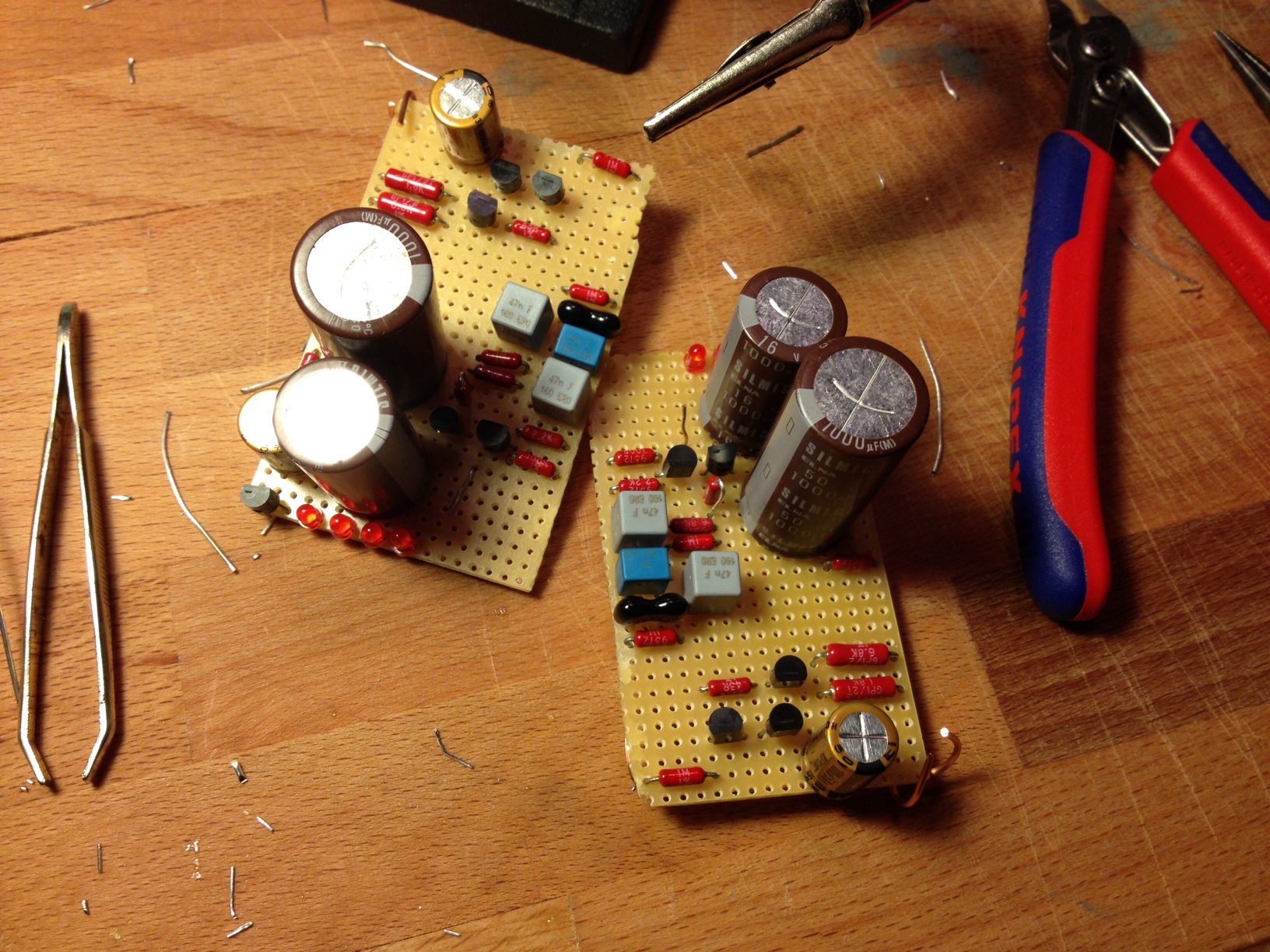

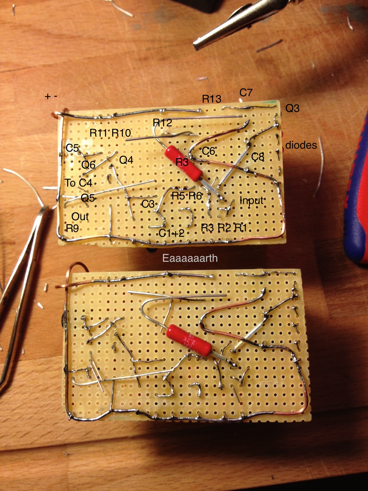

Here is my attempt at p2ping this thing.
It has space for a better c3 (obbligato), and needs a 2r2 resistor and a 200r potmeter until I can realise its not working. Its soon powered by a badly oscillating BiB. I´m hoping to pick up a Kenwood 4025 on thursday, so I´ll at least know about the problem.
Hoping for some honest input here. I know my way around the basics of electronics, but I´m in over my head here. As you can see, its mildly inspired by salas' layout. 🙄 I could not see where R3 was, so I just put it underneath.
I know the upper board has some extra space on the line between c2 and c3, and the leds in salas' build had some space between them. The c2 c3 thing is annoying me. But, on the other hand, the beer was great!
Oh, and I really dont know how I´m going to mount this in a chassis. There is no extra space for mounts, since I went for the smallest size i felt safe with. Its hopefully going to fit inside my lp12. Hovering.

Its been tested with a Bib 3 times. No problems. You can use double adhesive tape on some foam pad for mounting even.

Any special point of assembly worth attention will be mentioned in a full guide. Lets see if a proto will work and measure well first.
Thats actually quite clever!
Some stupid questions:
How do I earth this thing for the lowest noise? Some special tricks? I plan to make a thin shielding for it, as I mentioned I hope to have it inside my turntable.
How long can I have the cables from the BiB with sensing? Would 1/2 meter be waaay to much or not so much of a difference?

Best earthing is packaging and system dependent in each build. In general just a cable to chassis from the phono power node gnd with a floating reg suffices. Canned in shield box is very welcome for quietness. The Can should be its "chassis" in this approach. And then refer to some TT arm/chassis point probably. Convert the 1.1 in 2 wire with local jumpers on its output connector closing circuit locally if there will be EMI or instability with the long sense pair.
