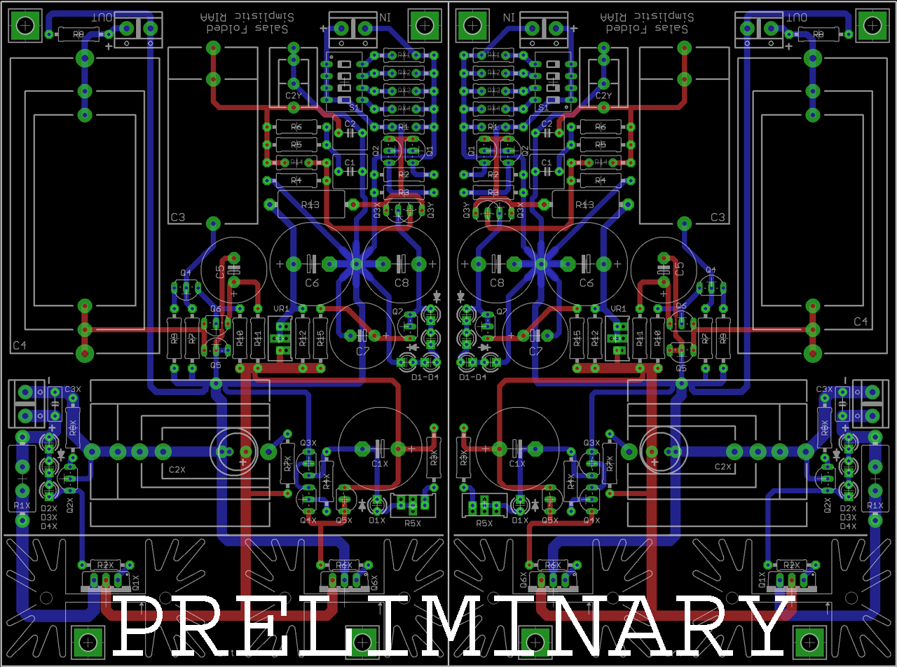

Meanwhile I guide lead spacing dimensional mistakes and errors after what crt sent back under my last guidance. We are slow this time, but nearing to proto worthy. Made space for MCAP EVO in the regs besides various industrial standard pitch, resistors are 1/2W, Z-Foil options, provision for Caddock Rset even. Can anybody pick out the glowing mistake in this one? Hint is I am not joking, there is a party killer repeated mistake there.😉
I can't help if there is mistakes or errors but looks very promising, can I offer me for beta tester?

But did you find the error yet? Hint 2 to help: "CAD mirroring".
Q2 and Q1?
Thought so too from the .png. But now I got a .brd file also that I can zoom dynamically to see that a blue line is connecting right hiding exactly under a red. So its a pass!🙂
