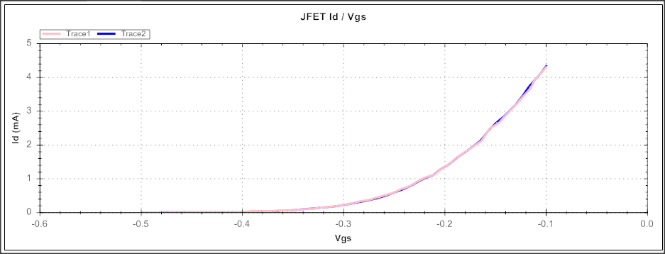

Its important to have the right value in this design, and yes, silver mica and polystyrene are great trim caps. As it is matching the semis well between channels. *Two K369BL of 11mA IDSS when tracing curves are pictured in the attachment.
You have got a new toy 🙂🙂🙂

Would you test some k170BL with 8mA and 7.5mA ?
Would like to confirm my findings.
