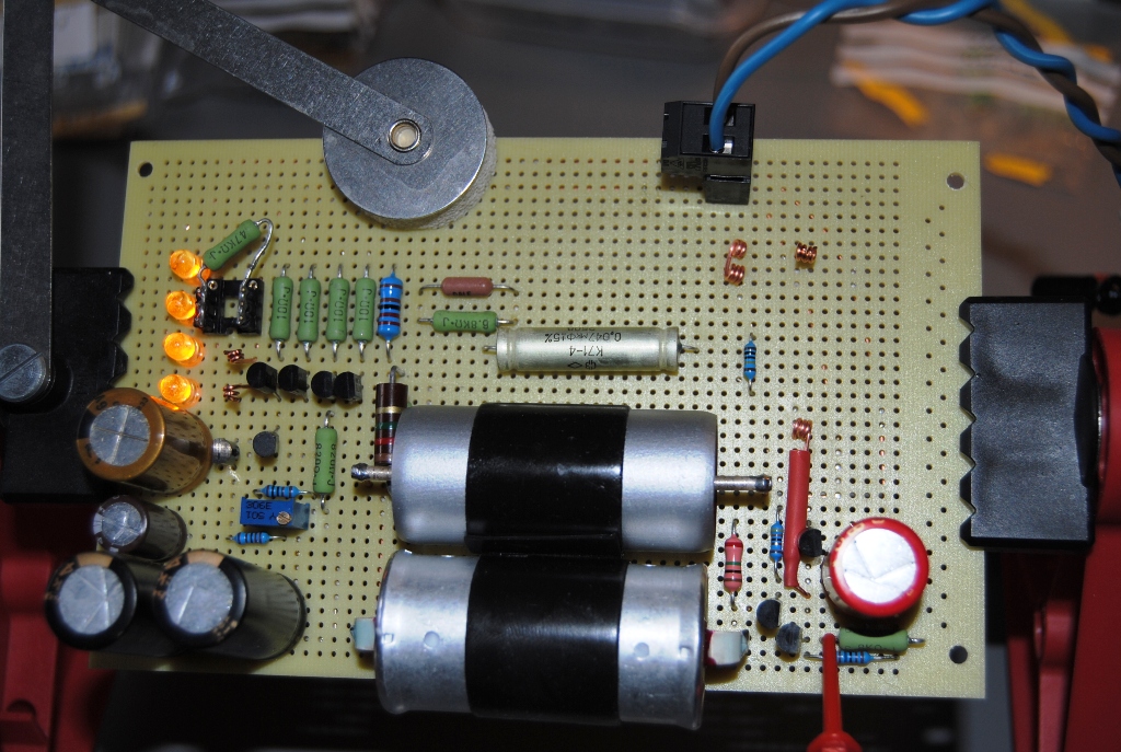

Another one up and running.
4 x k170 input fets
K72-6 Teflon 15n caps
K71-4 Polystyrene 47n caps
Full on second stage buffer (with fet ccs)
Now listening with a DL160.... no clipping... super silent... dynamic... Tone seems correct, must let it settle for a while, then retrim voltages and serious listenning ahead.
4 x k170 input fets
First channel worked right away.... the second one was build during rush hour so I was not able to set correct voltages on 1st stage.... I had .3v offset in the input and too much current on the fets (150mV Vdrop on the Rs).... I decided to remove the fets and place one at the time so I could track the culprit..... One bad fet I found (maybe due to too much heat).
After that, I had to cover the four trannies with a special "enclosure" so they should share the same heat... now music 🙂
