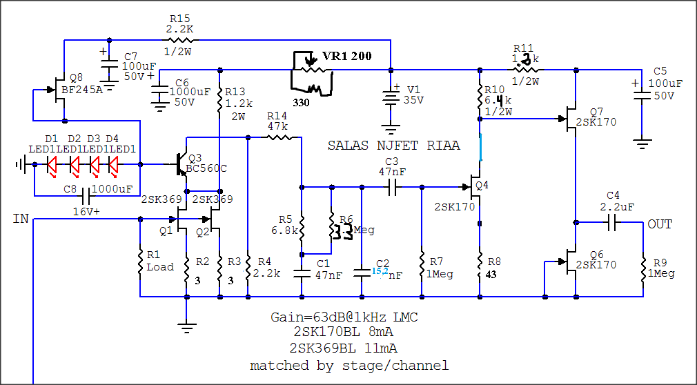

I have not been keeping up, Is the above a folded? 63db us getting close enough for me - but I would really like 75db. You know, because I can't let go of the sound of the DCB1 in my system. Oh - the choices.
Are you sure Felipe that a step up or an MC stage before the RIAA won't saturate it? I'm not.
Dual 170BL is 65dB, if I remember correctly. 63B is for 369 version
No, dual K170BL is ~60dB, single K369BL is ~57.5dB. Dual K369BL could go 63dB if redesigning especially for LMC. To reach ~75dB I would choose single 369BL driven by 20dB SUT. Don't know about input overload there though. Could couple to an on board amplifying stage than to the output buffer stage is better I think.
Could I use 2SK246BL in place of BF245A?
Better use K117GR.
Merlin's example is 63dB and is industry standard gain for LMC.
Better use K117GR.
Thanks Salas, wich Idss: low, medium or high?
