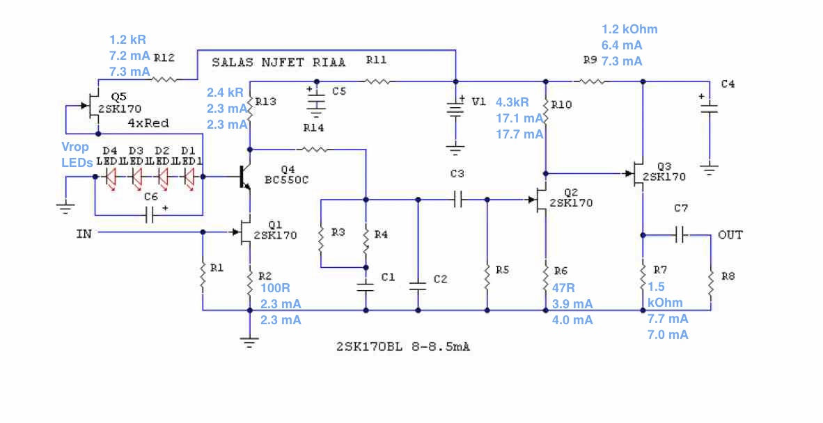

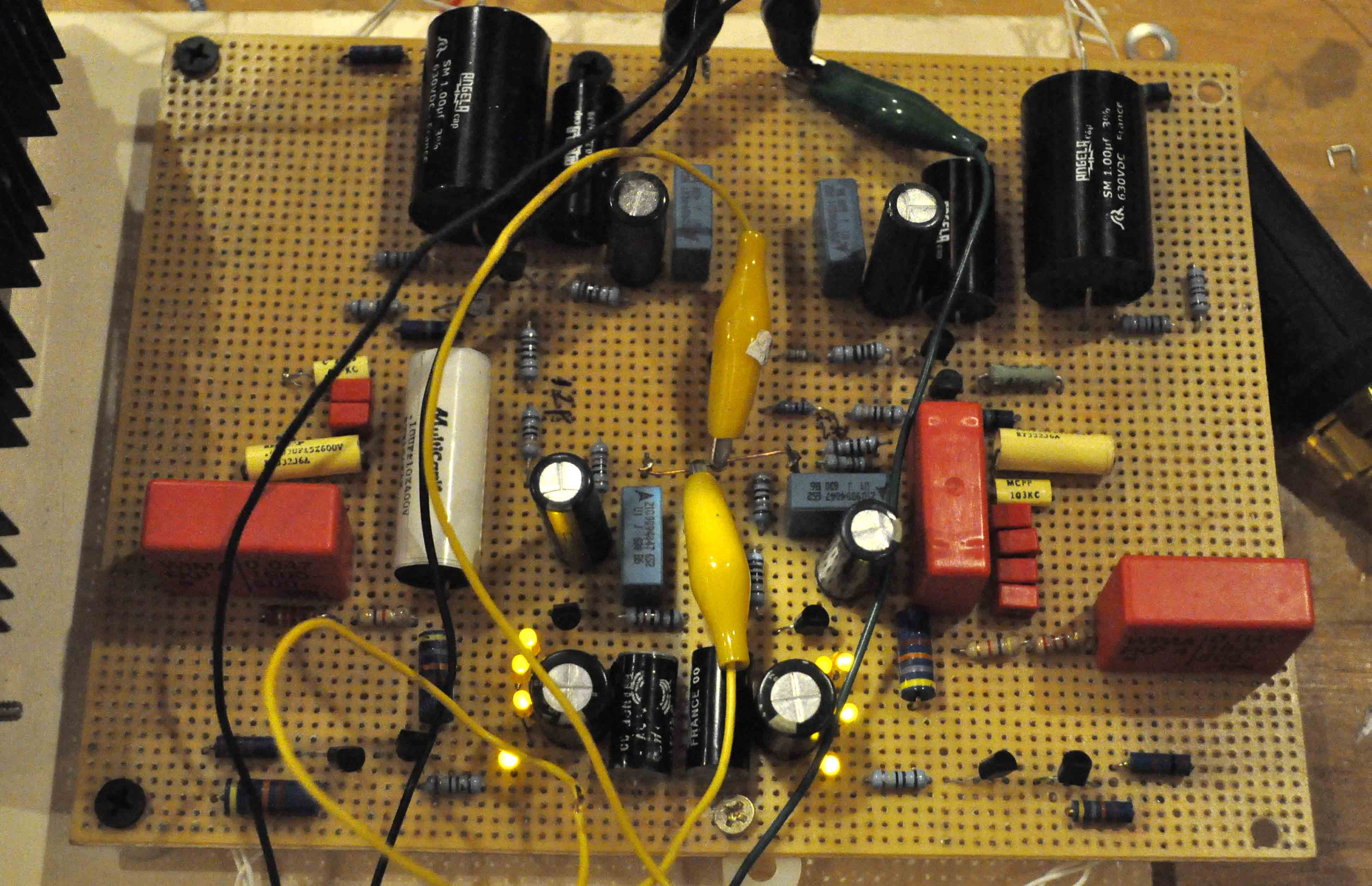

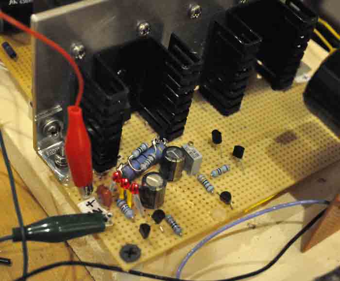

OK, hooked things up, and it actually played music. Only listened for a minute or so, then put it back on the bench. I was waving my soldering iron around and heard ZIP and something fried. Dumb!!! I will look at it tomorrow.
Anyway made some measurements across resistors, as shown below. Some differences between channels in a couple places, even though most of the JFETS were pretty well matched, except the LED part and the output buffer.
Do they seem reasonable?

HOORAY!
I went back and reconnected things, and everything lights up and looks OK.
Darn lucky!
Re-checked some voltage drops:
R2 (below Q1) - 2.3 mA
R9 (above Q5) - 6.7 mA
R7 (below Q5) - 7.3 mA
R10 (above Q2) - 4.2 mA
R6 (below Q2) - 4.0 mA
R12 (above Q6) - 7.2 mA
Look OK Salas?
Thanks!
