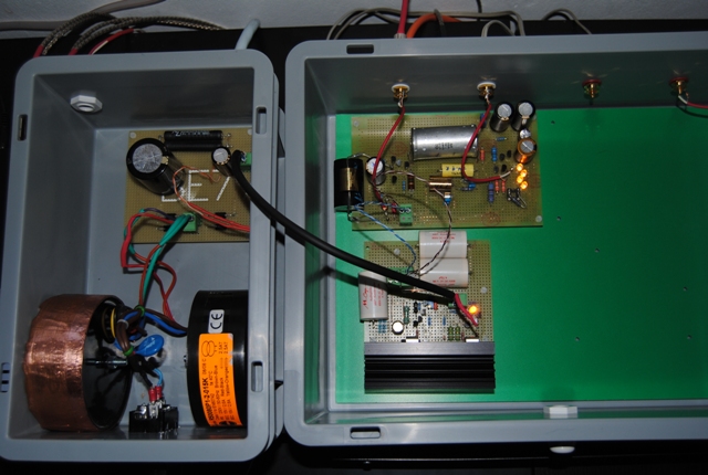

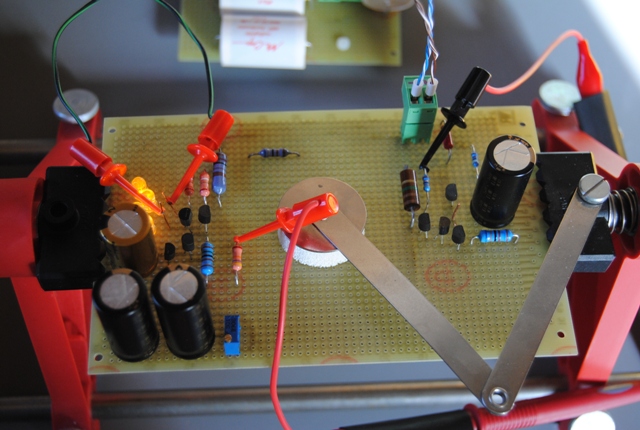

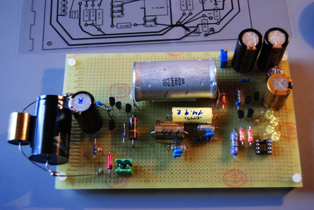

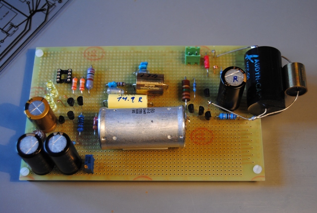

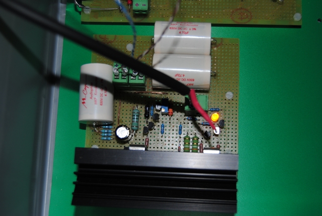

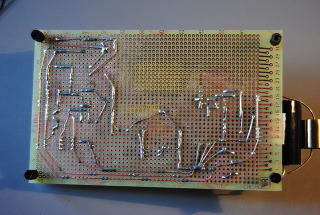

It worked at first try... Low noise, quite high gain (must be near to 60dB), very good tone (my riaa recipe 🙂)
I will let it burn for a while so I can post a serious listening impression.... for now I consider it a success, even with a low quality output cap it is very difficult to point any weaknesses.

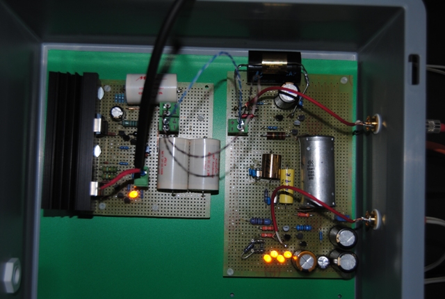

Its conservatively 58dB nominal. You could have hit near 59 or more. Listening with the Benz Ace? Any pic?
Only completed one channel so I am comparing it with paradise with a Denon cart.... that is why I believe I have near 60dB.
I am now finishing the second channel and only after that I will connect it to the Benz ACE and start serious listening.
Pics latter 🙂
Pics latter 🙂
Yes... one chanel on the "experiment", the other on the paradise.
You get more bench and connector organized I see. The Swiss factor.🙂 (The bronze guy set its constitutional base for those wondering about the Switzerland located bust pic).
DL160 should rather tax it, especially for scratchier records, this folded input stage is supposedly more dedicated to its nominal carts range, i.e. circa 0.5mV in the the one you made. You did not refer to distortion though with 1.5mV cart. Interesting. Off to a good start then. With the ACE cart should come more to its own and with a bit of run in. The output caps are on pins I see. Planning a "big blue" transplant for assessment?
Yes, I am getting much better with wiring now.... No distortion aparent with the DL160.... First impression:
Slightly dull highs....
Action - reduce high freq cap from 15,8 nF to 15.7nF... now it is starting to sing but I did not reach equilibrium.
My initial assumption was second stage miller around 40pF... now I know it must be way larger.
I read something about cascoding reducing miller by 1/3.... am I right ? If so I can reduce the cap to 15.5nF and possibly get away with it...
