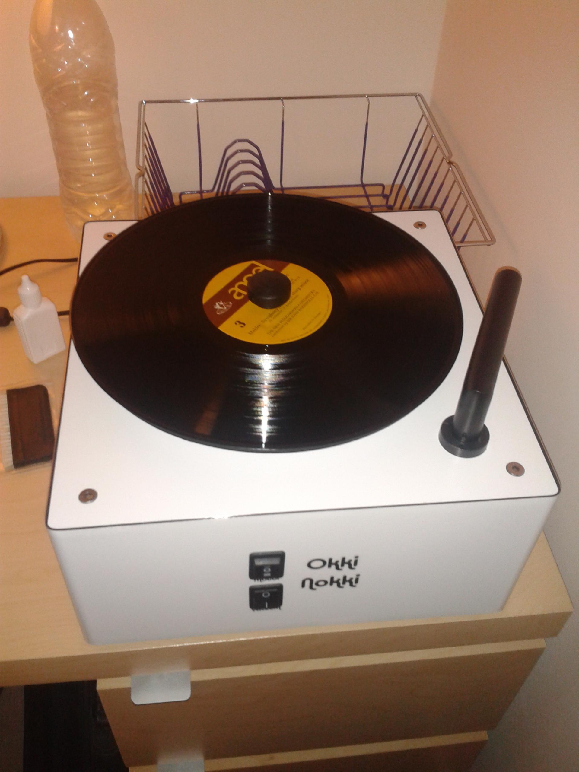

I would also like to mention that big gains in sound quality, sometimes bigger than fancy components on the RIAA, can be gained by clean records!
I can't imagine how I could live so long without a record cleaning machine!
