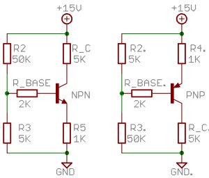

hFE on BC550C on eBay (yes I know this is is a chance to take)
I have bought some BC550C on eBay and I used the schematic under for the the NPN, and calculated the hFE to match in pairs. the measurements varied between 246 and 314, and there was many good pairs .
Then I took one of the BC550C from the "BIB set for the Salas 1.1" and this one measured 474, so are the ones I bought good enough, and should I buy a load from the quality vendors? The ones I bought have a silver front, with black marking " C550C PH 99 ", are these good enough and not fake of some sort? 😕

Headphones are a trusty evaluation tool. But they have to be the neutral kind to judge well. Use AMTRANS 1M. If you want good hfe, lowest base spread resistance and noise, higher Early voltage, although not critical in the common base BJT part of the cascode (BC550's role) locate a Japanese exotic.Like Hitachi 2SC2545,6,7 E or F.

You will let us know if you can pick up any difference, as I said its not that critical there, regardless the version. I just let you know what is highest spec since you put an expensive build effort and you ask about BJTs anyway. If you can't locate any of those special transistors, 2SC2240BL Toshiba is easier to get, still ~1/3 Rbb' than BC550. The Japanese ones got their pins different, remember to check out if exchanging types.
The 2SC1815 has better Vcesat parameters. What I'm looking at is the Ic vs Vce curves. For the C2240 the curves straighten out before .5V Vce, this is very good. For the C2545, they straighten only after about 4V; I wouldn't use it in a current mirror. These don't have much to do with the Early voltage at above 4V Vce, which will determine PSRR as long as you don't go too low. It is not necessarily possible to tell which will have less leakage above these voltages from the datasheets. Whichever has the least slanted lines...
