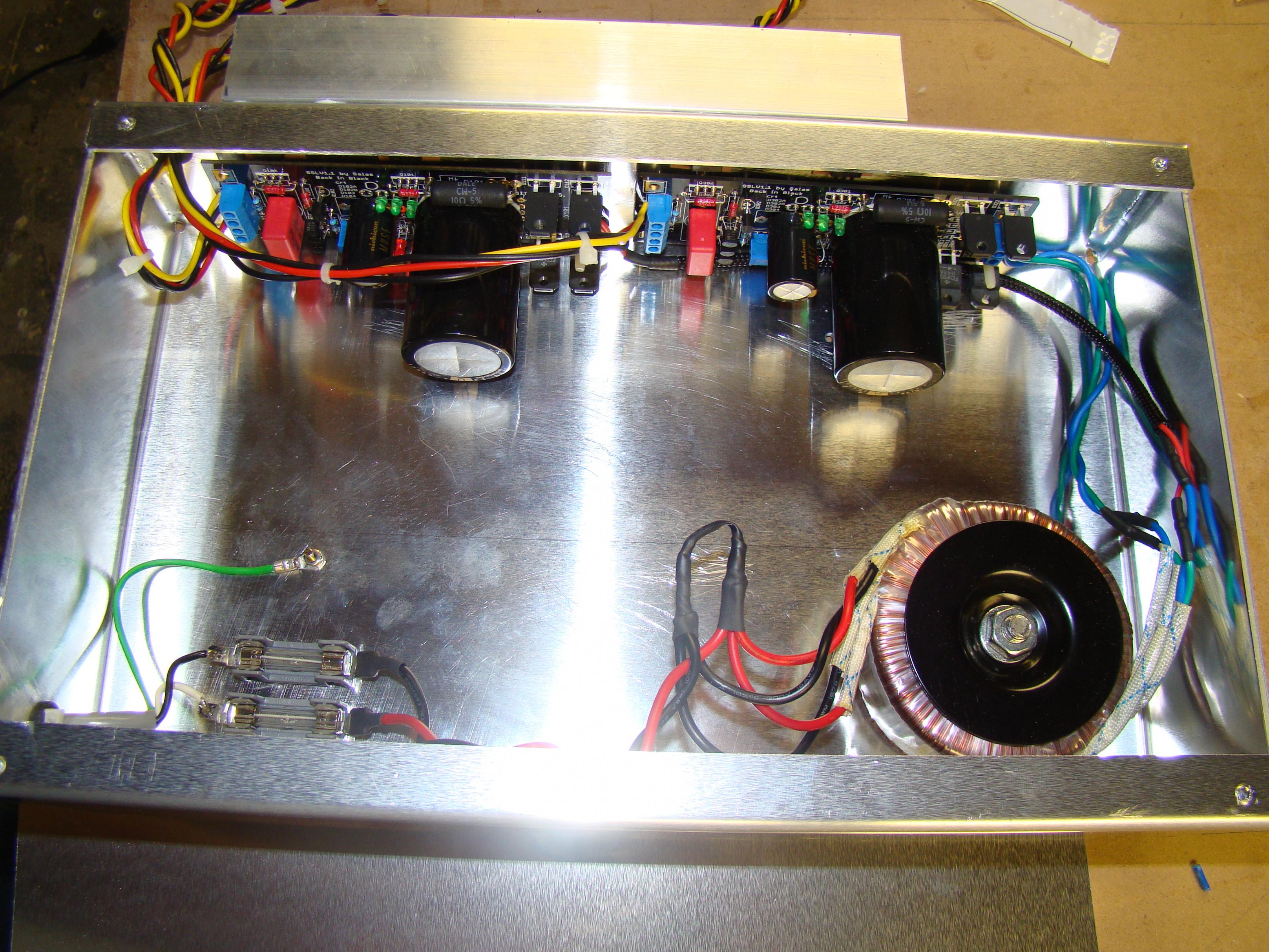

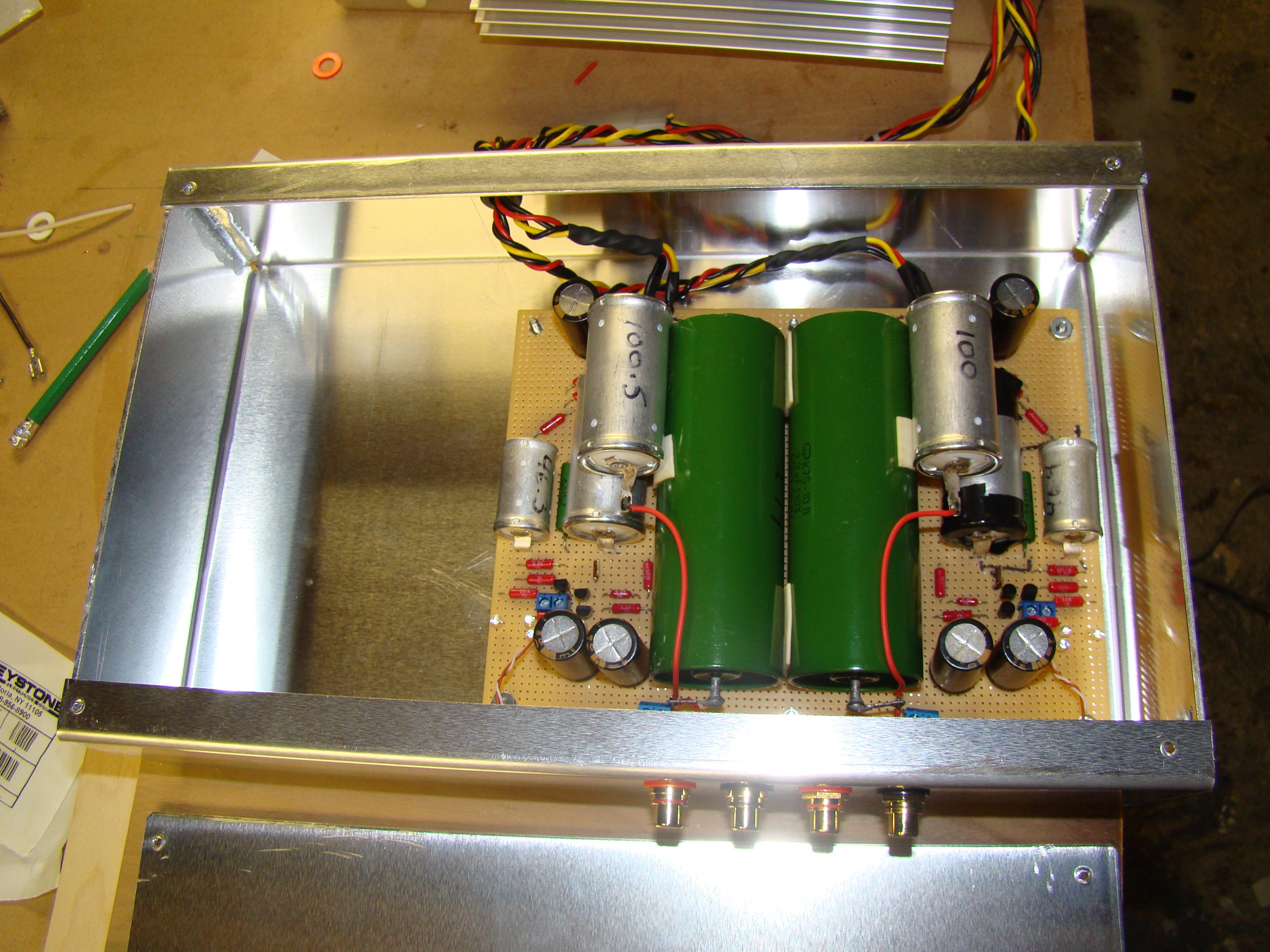

Boxed up my rig this evening. The results are all I hoped for... total silence...except for the music. The kids are in bed so for now I can only listen at low volume, but the sound seems excellent. I used better parts for this build, as well as two chassis and the effort and cost seem well worth it. Thanks again for the help, Evan
I changed so many parts from the first build it will be impossible to tell where the differences come from.
I wired ground from the one box to the other using a connector held down by one of the cover screws. This also gets the arm ground. I did not ground the shell of the caps...I didn't notice any difference in the hum when I put a finger to them. Maybe this will have to be addressed if I go for a lower output cart. In the future and implement a mc pre preamp.
What I hear now even at moderate volume is a richer bass as well as improved detail. It also sounds to me , and I know it's an illusion, is that the speakers have moved further apart and the room has gotten bigger....open your eyes when the needle lifts off the record and wham I'm back in my living room.....
