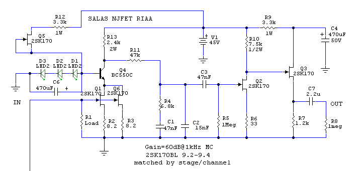

Simplistic NJFET RIAA
Have you tried to use small caps, ~ 0.1µF, soldering direct to the pins of the LM317 (from input and output to ground)? This should avoid oscillation.
No I have not tried that but I got a couple of circuits I am working on.
As I said at the begining of my adventure with Simplistic this is a realy good way to learn things (which is what interest me) so I will give the small capacitors a try and for this I tank you.
I got a board ready for Gyrator folowed by 317 and I will put the caps there and see.
I will need to do back to back listening which, as you ask I feel is the least I can do after all your help.
Fortunatley with new job I am now working 12 hours shifts 4 on 4 off so soon I will get plenty more spare time to try things out. (main reason why I have changed jobs but do not tell her please)
No hassle at all I think is actualy a realy good question.

You're welcome and I'm glad if I can help you. Aside audio design it's common known that those little "dears" need thos caps.
Anyway, I think with Salas low voltage regs you don't need a LM in front, so just go for a good energy storage with LC or RC filters.
Another way is, like Salas mentioned to use batteries ... but this is another cup of tea.

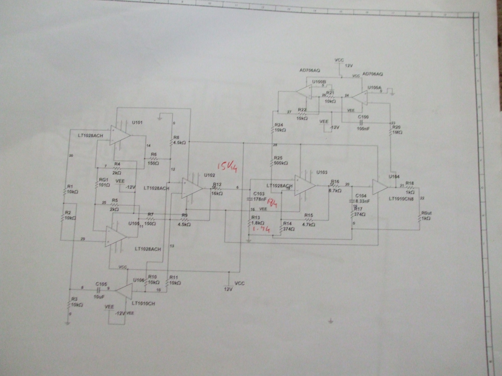

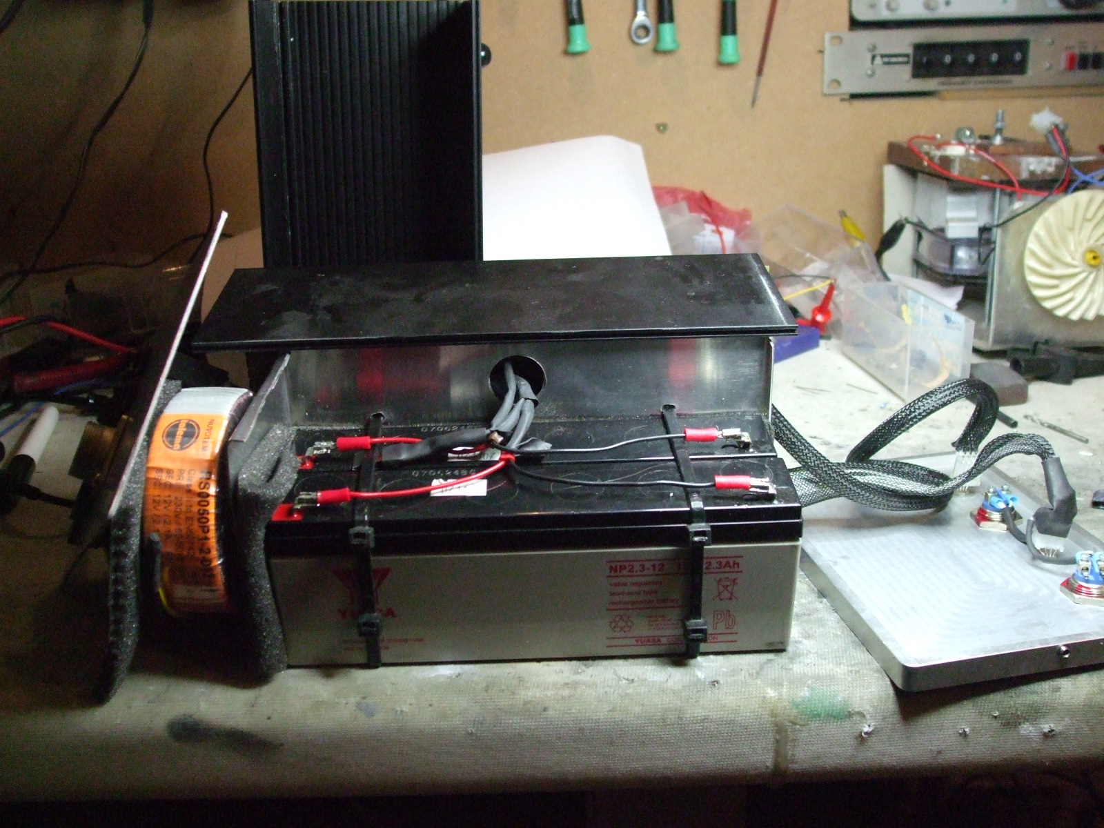

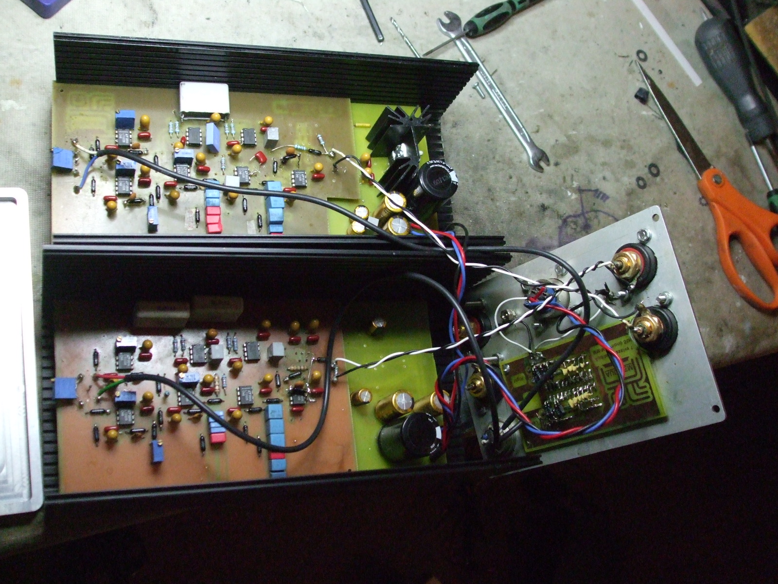

I started up with bateries for a INA like mc stage I designed about 3 / 4 years ago it had 6 LT 1028 and a couple off DC servos.
The charger was a LM317 with a transistor for costant current.
But I wanted to go away from 8 leghed critters and learn how to use transistors and Jfets.
IMO the simpler the circuit the better it sounds
