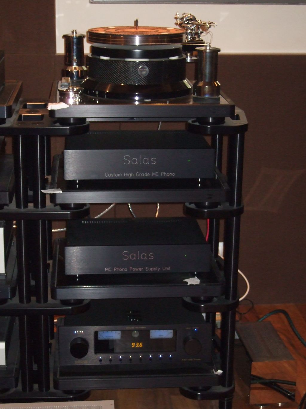

Had one made for a friend who has a Zanden 1200S. He took it out and uses the simplistic, says he prefers it. His cart is Clearaudio Goldfinger Statement. You can see the orphaned Zanden PSU on the floor. About EB320, haven't chanced on any.

I had one EB320 for some time and than I built the simplistic with V12 and this one is much bolder and spacious.
With the V12R is even better providing a wider soundstage tempered with just the righ amount of presence and attack.
In fact I compared it with numerous high end machines and I did not find anything near it´s ability to present high definition with sweetness.
