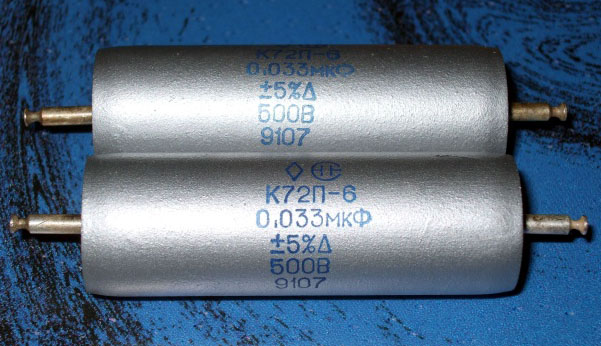

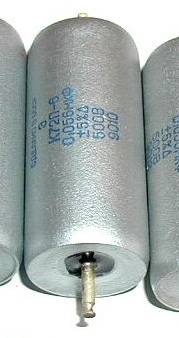

Just reporting that I have rebuilt my 'Salas RIAA' and replaced the Wima FKPs with Russian 0.3% silver/mica and Teflon caps. (Pics below). Large caps - the layout has extended further into the third dimension, with caps towering over the dead bug fets.
Wonderful improvement apparent already, although when I first switched it on the bass was so excessive I thought there must be something wrong with my wiring or with the cap values. It settled down after a while, and I concluded that it must have all been too much of a shock to the poor Russian caps - after years of slumber in a Soviet military store 😱 😱 😱 they are suddenly transported to England and asked to play American music through a RIAA stage designed by a Greek. 😱 😱 😱 Next challenge for them: Charles Lloyd, "Fish out of Water".

Silver Mica - shunt RIAA caps (3 in parallel for 47nF)
Happy listening to all-
John
jonners said:Teflons - 2 in parallel for series RIAA caps.
What a coincidence! I just came back with a couple of those! I want to try them for inter stage coupling in the RIAA. You are appointed as the official burn in authority and sonic compatibility reporter before I remove the CCCP Polysterenes and try those.

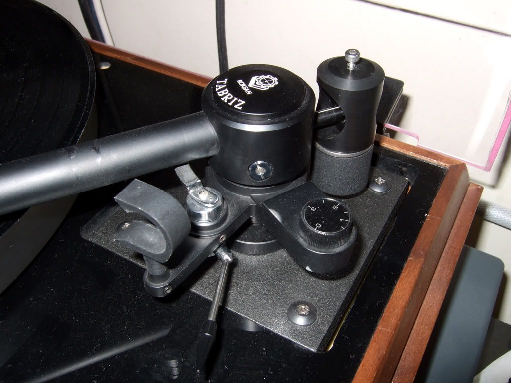

Wow! How nice our circuits passed music from this nice TT... Cool stuff.
clearaudio CONCERTO on Roksan Tabriz picked up vinyl grooves really well...
Wooden cool On Tabriz
A really well made arm. Smells Japanese OEM?
Back to ole British shores, Origin Live DC motor mod PSU.

kstlfido said:Jonners-
Where in the circuit are you using these russian caps exactly?
The paralleled Teflons are the inter-stage 100nF. Three parallel silver micas to ground for the 47nF, one to ground for the 16nF.
Dr Jonners
Thx Jonners. Jeez- it must be a really crowded board- those caps are big! 😀
Mmm, I have some 100nF Russian FT-3's.. maybe I should give it a go...

Nice TT , carbon fiber matt?
your friends need clean better the LP🙂
the psu for TT are another question to answer! a simple caps to derive 70-90Vac for motor.......is important isolate the motor from 220v ? (x2-common mode coke-x2)
Salas do you have a shunt for motor?

nicoch46 said:Nice TT , carbon fiber matt?
Yes, carbon fiber mat, upgraded ZI spec arm, Origin Live DC motor and DC PSU. So no AC tricks. But if you ask in general, build a Geddon. 500VA trafo good 0.2uF cap for 90 deg phase lag. I have listened with just isolation trafo and yes, the best benefit goes to AC motor TTs.
I have thought about shunt for DC motor. Problem is that they ask for 2-3V and Mosfets open higher. So I must do it with BJT.
Music's over.😎
