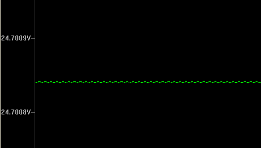

You are going to be so disappointed, your shunt will have so much ripple!:clown:

Forgot to mention, the simulation file from a few posts ago is all inclusive; I meant it to be easy for any beginner, so all you need is to load that file in ltspice and run it (I have no affiliation with linear technology, I'm just using ltspice because it's free, has no limitations, is actively developed, and quite good). For those experienced the following few lines will be boring. The actual simulation takes a bit of time because the sim parameters are set for more accuracy (helps with the harmonic distortion analysis). After the simulation is run (by clicking on the "running man" button), you can click on the menu on View->Spice error log, which will show harmonic distortion numbers. Or you can click on one of the circuit lines, and it will show the voltage trace at that spot; when you click on a resistor, it will show the current trace through it. Again, maybe not reality, but fun and educational, for sure.
