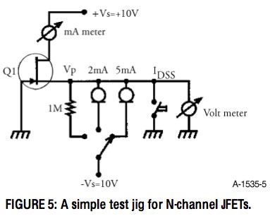

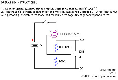

Measuring Vp
Briefly free from a work spell, so time to tinker! I'm trying to come up with a quick test for Vp. Google search reveals many ways to do this, some rather involved.
I've attached two similar simple measurement techniques- the first is off the run-off-groove site, the second is from the Erno Borbely paper on jfets.
The Borbely tester uses a bi-polar power supply. Is this necessary? I have one, but but it's buried. All I have right now is a dual 0 to 6vdc supply I'm connecting in series to get 9vdc.
I appreciate any help on the matter.
Thanks- Kent

compare the two diagrams.
with left switch to Idss the 1M is shorted out and the voltmeter reads the voltage across the 100r. That is the same as the right with the Idss switch closed.
The main difference between these two settings is where the current is measured. on the left the voltage across the 100r lets you see the current easily. The right can use an ammeter or preferably a 100r and the another voltmeter.
Now switch the left to Vp. The 100r is shorted out and the voltmeter measures the voltage across the 1M. There is a problem that I will come back to.
The right uses the switched 1M for a voltmeter reading. Note there is no other current flowing to that ground. It is a floating ground that is only used by the voltmeter. Effectively you have a single polarity supply of double the voltage. It is effectively the same circuit as the left most diagram.
Now the problem:
A voltmeter is usually specified with an input resistance/impedance. A DMM can be anywhere between 1M and 100M and very common to see 9M or 10M as input impedance.
measuring the voltage drop across a 100r resistor with a 9M voltmeter results in a tiny under-read of the voltage The actual resistance is reduced to ~99.999ohms (the last 9 is actually 88 repeating).
You are measuring the voltage across 99r999 and you can see that the current value is so close to the assumed 100r resistor value prediction that we normally ignore the under-read and assume it is accurate.
When measuring the voltage across 1M with a 9M voltmeter, the under-read is gross.
The effective resistance is 1M//9M =900k.
The voltmeter reads the voltage across a 900k resistor but you think you have read the voltage across a 1M resistor. There is a 10% under-read. If you want 1% accuracy you must take account of the voltmeter resistance whenever the test resistor is within 1% of the voltmeter input resistance. This would apply whenever you measure the voltage across >=100k for a normal DMM. With a 10M load for measuring VP the error is much higher. The reading is almost worthless without taking account of the correction.

For matching purposes I would use the left one with 1M, which is handier. Works with just one battery, and will show same deviation % error from absolute real Vp for all samples. I would not use its IDSS function, I still prefer a straight in line Ameter for that. When the IDSS is much different, the drop on 100R changes the VDS enough and affects the standard. Say you have a range of 6mA to 15mA JFETs to test for IDSS, that would change VDS from 8.4V to 7.5V for a 9V battery.
