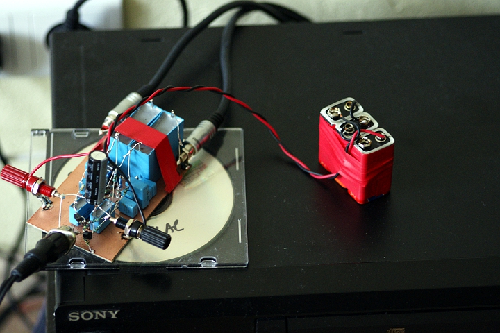

while my parts (2sk170bl) for the Salas preamp still travel to me, i I quickly and dirty assembled pacific style riaa with 2sj74 bl transistors and RIFA polypropylene caps. Sounds very clean and nice. gain reduced to 0.5V at output -sufficient level to my le monster amp and also lower gain - lower THD.
Next will be Salas preamp and shunt regulator.
And thanks for useful info in this thread.
thank you,
I am a Newbie in LP field. MM cartridge is simple Audio Technica AT72K , details i have not yet studied but sounds nice to my ears.
Odd you photograph a phono preamp on a cased CD! I have built 4 Le Pacific based preamps but are yet to build the oroginal. All mine have been based on the boozhoundlabs version of the schematic. I am looking forward to building the original. In the middle of building a 300B power amp so it will be a while.

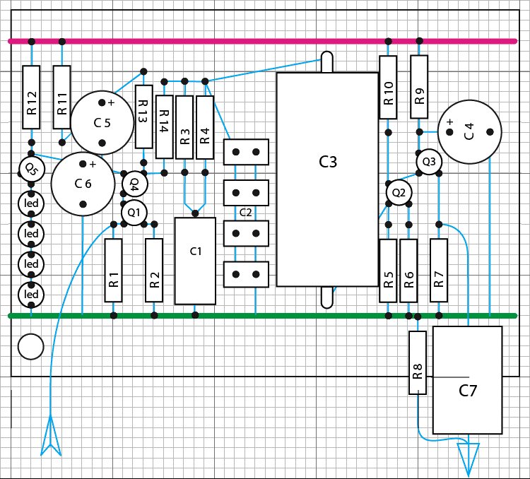

I'm gearing up to make a 2nd Salas RIAA, using version V1102F0.pdf. I'll use the 1.2R shunt. P2P on vector board. Initial layout attached.
Cartridge is Benz Glider LO2, 12ohm impedance, 0.42 mV.
For the R's-
Possibly Shinkoh's for the R loads & RIAA R's.
Probably use PRP resistors for the rest.
I scored a bunch of Vishay S102's, Are they any good?

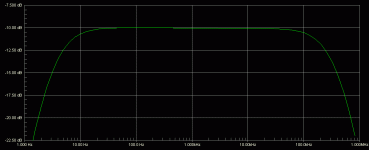

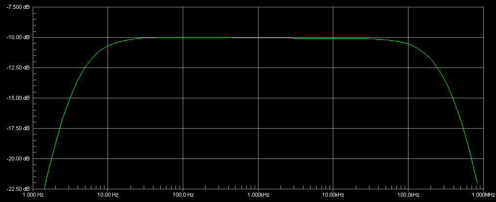

Hi! That is what the simulator gives for that CCT when driving 7K load with a 5.6uF C7 (attached). I think its adequate and still skips some low disc warp gently. Yes, 1.2R's Vref cap is shaping the tone enough. The output film too, but plays second fiddle.
Muse or Silmic, hmm depends on the overall character its going to strike in combination with the TT. You should check for real.
About Vishay S102 I have only seen opinions on the web. They say TX2575 ($) is the one and S102 comes next. Vishay is top quality spec any way and I would do a test in the load and Riaa positions if I had some, so to evaluate if I could hear something in the long term.
Since your cart is Benz Glider 0.42mV better do the slight changes on previous page's post #5875 that gave 58.4dB to smpkje since he felt he needed a bit more with his same output spec Shelter 501.
Best regards and good luck, the layout looks logical.

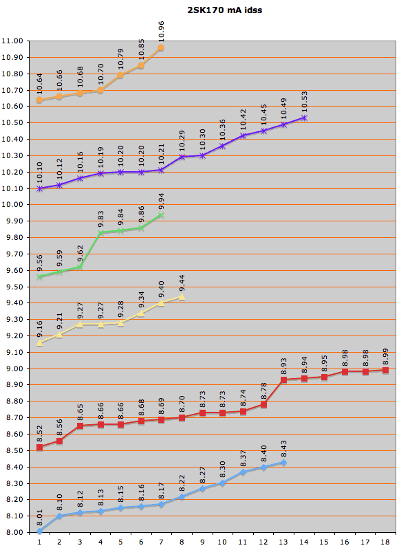

So after grouping ~150 k170 jfets into quick current piles, i had 67 that were 8mA or better.
Got out my nice PSU, set up my meters and accurately measured the >8mA pile. 9.00vdc. Room at constant 70'F. Gave each jfet ~10 min to settle. Used proto board- no hands touching jfests.
Using 0.02mA difference as max, I came up with 16 pairs-
8.12____8.69____9.27____10.20
8.13____8.70____9.27____10.21
8.16____8.73____9.83____10.29
8.17____8.73____9.84____10.30
8.65____8.94____10.10____10.64
8.66____8.95____10.12____10.66
8.66____8.98____10.19____10.68
8.68____8.98____10.20____10.70

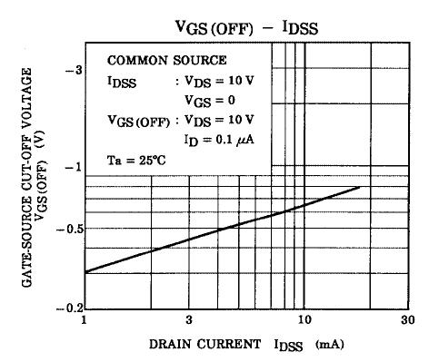

Should I test for Vp as well? I know matching is a hotly debated subject and I'm wondering if Idss is enough.
The attached graph shows test result dispersion.
Cheers- Kent

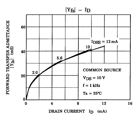

-Vp and Idss will affect bias when Yfs (gm) will affect gain. More Idss indicates more -Vp and top Yfs, but Idss is not affecting transconductance changes severely when the bias Id is the same (1st pic). So to keep same Id in a circuit without trimming resistor values for each fet, we need similar Idss and -Vp. As you can make out, to really say we got two identical JFETS we need to trace em out dot to dot measuring or have a tracer machine. If you can measure -Vp (VGS(OFF)) for a few samples around the 6-7-8-9-10 Idss marks we could see if the second attachment from TOSHIBA is still relevant. In general your batch is well proportioned and you have many around the 8-8.5 Idss reading in the end. Good thing is that in circuit Id and gain followed the modelling very well in the recently posted made and measured circuits that followed the PDF resumed values and instructions.
Okay. Will test -Vp soon of the selected fets. I need to get out my other supply as the one I'm using only goes to 14V.
