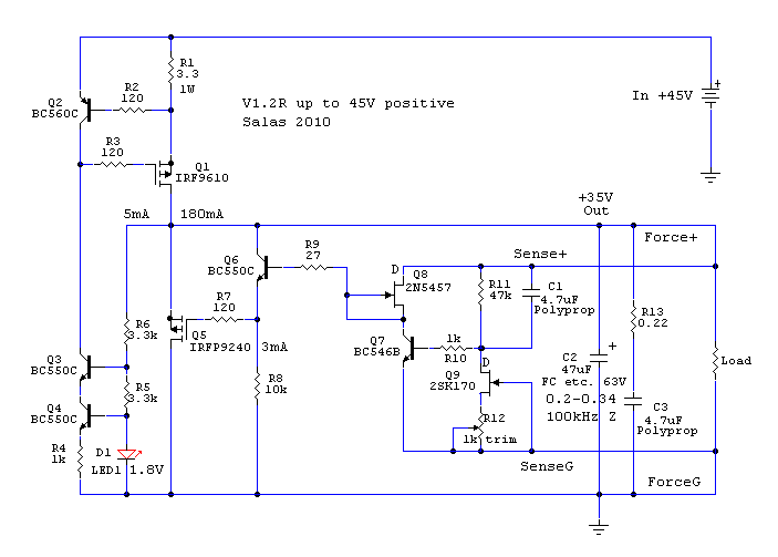

This one is the best reg V1.2R up to +45Vout maximum changing the trimmer R12 for 500R for +45Vout for minus voltage you can use trimmer R12 1K as like the schematic

About mosfets & semis use exact as per schematics don't need any kind of selection hfe & Idss.
Yes C2 Pana FC 63V because Salas designed with it.

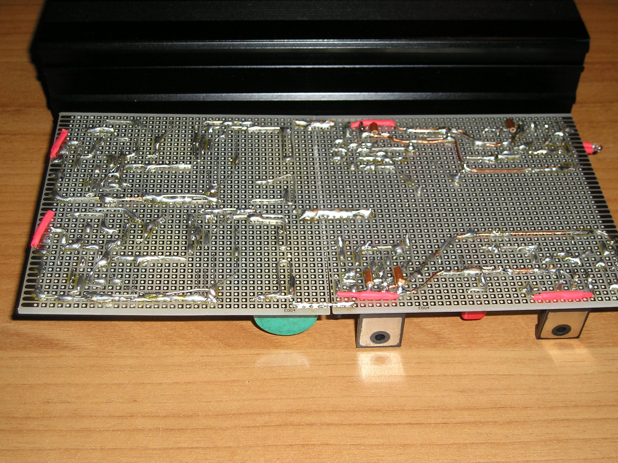

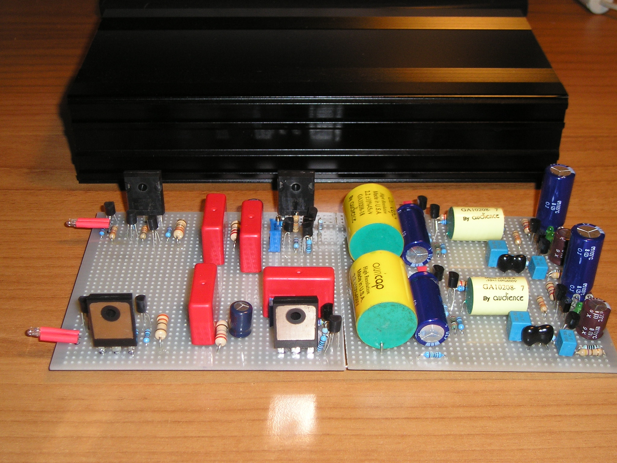

Hi Salas,
okay, ill do the bypass and then listen. On the other hand, i found a pair of
those green russian pios in my box, I could try these as well. Unfortunately
they are quite big and i really tried to keep everything close on my pcb.

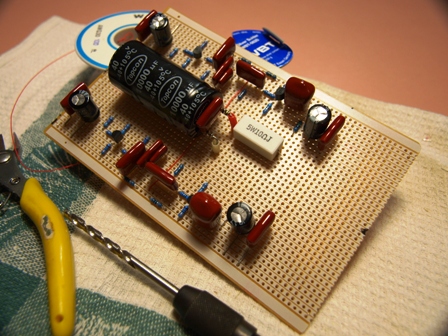

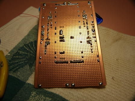

@ all anyone has some ideas how to arrange the v1.2r ptp on solderstripboard
to get maximum performance and no oscillation ?
Gruss Ulf
You may recall I had some problems with resonance and brightness with my boozhoundlabs/Le Pacific phono preamp. While constructing one for an audio club member I realised, in mine, I had used the equiv. of a 0.0034uf cap where a 0.034 cap should be.
Once the paid job is finished and tested I will replace the errant caps. Here is Martin's build so far.

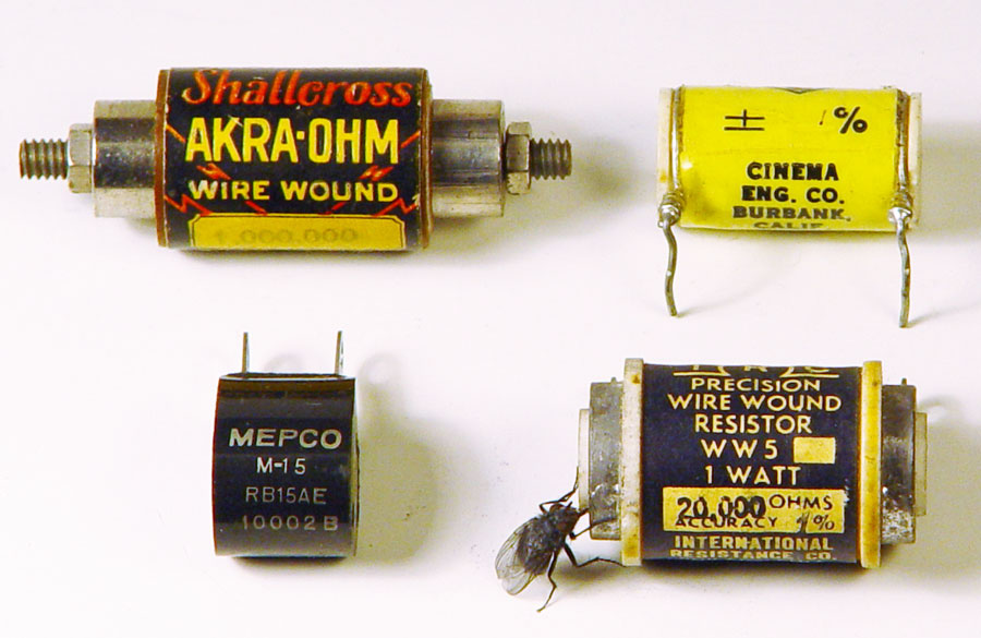

Old resistors
It's been a while since I posted here, been lurking, though! I ran my Salas for a while, but ran out of time to play with it. Needs some serious updating; much has progressed here since 2008.
Just wondering if anyone has used old-school wire-wound precision resistors. Are they suitable for my Salas phono stage? Shallcross, IRC, etc. I've got a box full. Pic attached.
Fly not a resistive element! :D
-Kent
diyAudio Chief Moderator
Joined 2002
I don't remember anyone reporting about having used such parts. If some are wound in a non inductive manner and you can tackle the layout nicely due to their bulk considerations, why not. The cart load resistor and the series in Riaa filter one are the most detectable, you may try on those even on your existing phono and decide if they are doing something positive.
