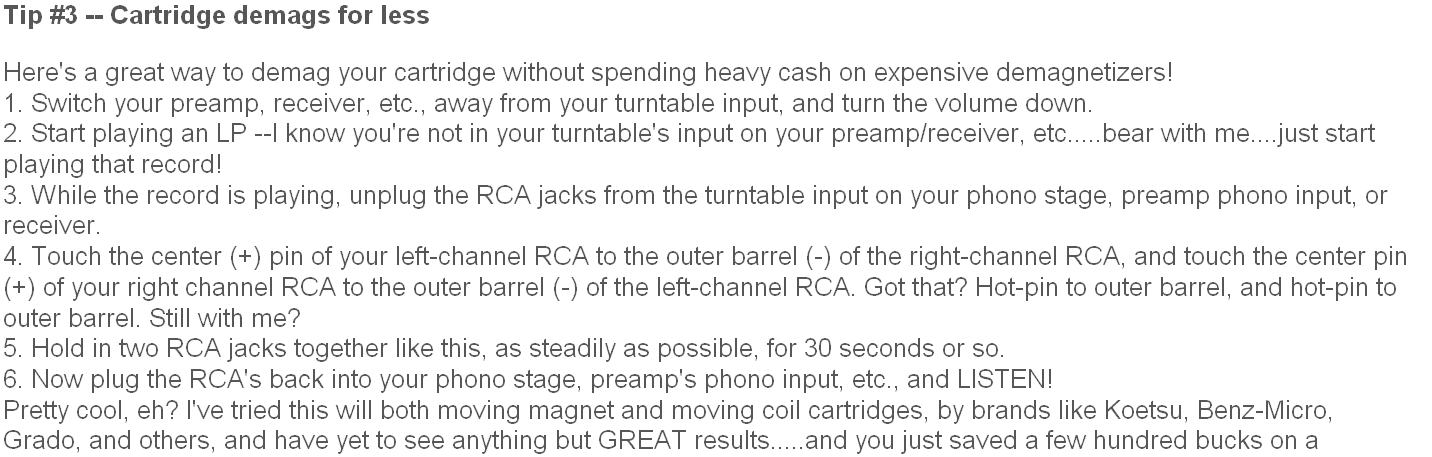

I would not use an active demag gadget if there was an issue, I would prefer the cross short its outputs while playing pink noise tip to test.

found this for free 😛, but need a beta tester......
I use this method since I use MC-carts and it functions very good. Try it out and be the 2nd beta tester!
