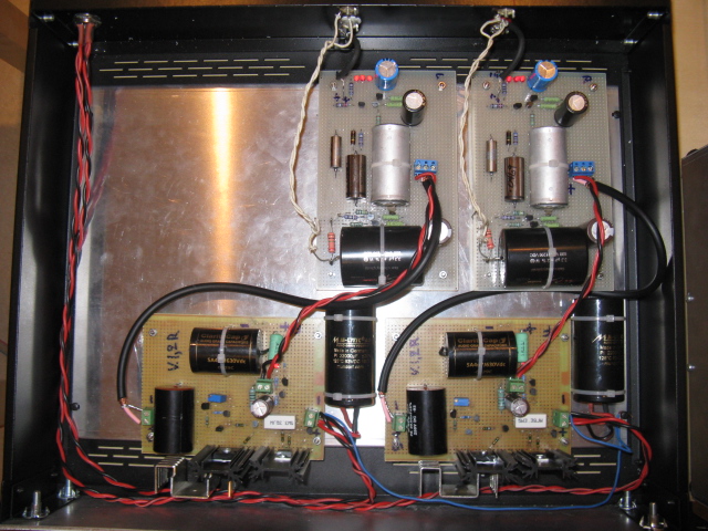

After a few days listening to the RIAA, I can say that I am really happy with the final result. A big improvment from my previous non cascoded build. More dynamic, more resolution, more 3D sound, more of everything. Also it is very balanced. It' s like having another stereo! It was well worth the effort put in building it.

Nice one VG, enjoy. What is that blue wire in the phono? Some grounding to chassis? Also what type is the output twisted pair? That No26 DHT line pre is a big machine now I see it with its separate supply box, by the way. Should have taken quite a construction effort.
the blue wires were temporary are they are removed now, as I run a seperate ground wire from the PS box. The picture is from yesterday.
As I have two big 10H chokes, heater pregulation with 2x15000uF per channel, 3 transformers, 2 anode chokes and 2 SSHV, I do not think I can do one box!
This was morphed from my previous 12b4 pre, so there are a few extra holes!

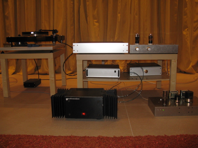

Also FYI, I changed to battery bias bias and put an 470nF FT-3 output cap (I liked this very much! I would like to have a similar value of Mundorf silver gold oil to compare. It is going to be difficult to better it.) on my #26 pre and things improved even more.
Everybody serious about records should give this a try. It' s one of the best sounds I ever heard.
Congrats vgeorge, very nice system, for sure sounds very very good🙂.

To aid ventilation, you planned it all along.🙂 What kind is that cotton jacket(?) twisted pair wire you use for linking the phono output to the boards?
The ouput wire must be shielded😉
Salas, this is silver wire gold plated with cotton insulation.
I have some VDH wire also that I was planing to use but couldn' t find it when I was bulding it! Found it later of course! Think I should change?

OK. Keep 150pF extra caps to make tuning steps. VG's 15mA Vjfet custom simplistic lends it self for 15n straight Teflon by its intrinsic alignment I used, yours may need a bit more than 15n or not. You will see.
Input wire must be shielded, but output it depends, I think. Also my interconects are not shielded right now.
No if you don't get any buzz noise. You get any? You got no Tx in that box at least.
With my DCB1 I have no noise, even on the horns.
With the tubes more of a little bit hiss. I do not think this is a problem of the phono. I always try to route my cables away from the transformers, power lines etc.
If there is no buzz (zzzz 100Hz to 1kHz harmonic noise) from the source, just different hiss from the line preamplifiers does not have to do with the twisted pair, and you may keep it since your system tonality is great as it is now you say, not to disturb it.
I don't have shielded output wire either. iMHO it is better to avoid it if you can to minimize capacitance. I usually don't run shielded interconnect either. only when I have to.
I have a couple of shielded interconnects which seems to me less dynamic than the ones, pure silver, that I am using now. With the tubes, there is slight buzz only listening right at the speaker. I am certain with different tubes and a little work on layout can make things better. Tape noise from analogue recordings is a lot louder.
For the moment I am listening one of the best sounds ever listened.
