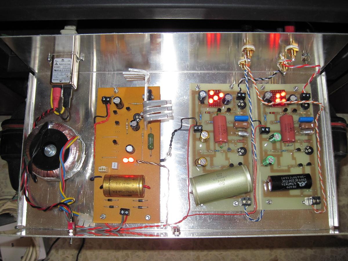

Spent the past few days tweaking the amp to get the required voltages. Finally I got it sounding to my taste and prepared to put it in a case (a humble one at that!) This is the version I'm listening to and it sounds great. No hum or whistles. Output caps are not identical but I like the sound of the (large) Russian PEPT 3.3uF better. Later on I'll change the other (SCR) cap. Meanwhile, I attach a photo of innards of my Salas nj-fet riaa. I encourage other vinyl lovers to build it. Cheap to build (compared to valves), lot of help on this thread, fun (and a learning experience in my case), and above all GREAT SOUND!!! THANKS A LOT AND WELL DONE, SALAS!!!
