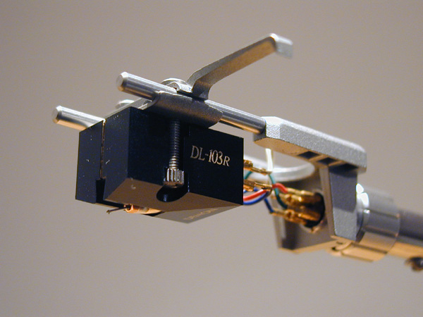

60db-Version 11.0mA IDSS for DL103 R Post 3767 ouput cart 0.25mV
Simplistic NJFET RIAA
