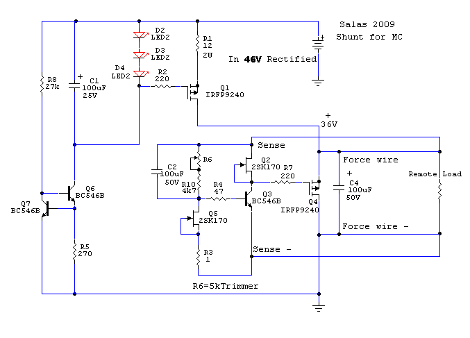

Would you please recommend a circuit including salas-reg-psu to
me to ideally play with my lyra dorian cartridge as asked some post-
ings before.
Greetings Ulf

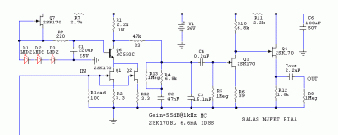

Use your matched ones for Q1,Q2,Q3,Q4. I fixed it for double njfet first stage so you make full use of your available pairs. Find two near ones for Q7, within 1mA any idss from 6-10mA, not critical. 2V green LEDS everywhere. In the PS use for Q2 your lowest IDSS.
Make sure that the idss you mentioned is correct. I use the 9V battery and current mode DVM in series with no resistor simplest method and is always spot on. Good luck.

Salas,
you´re great, thanks allot. I´ll build this pre then ;-)
One question at the moment: What jfets should be
thermally bonded? Q1/2 i guess
What about q3/4 then? And psu fets, should they be
thermally be bonded?
Do you have an idea what´s the Zout of this phonopre?
Greetings ulf
No one FET needs to get bonded. Q1, Q2 have highish sharing source resistors they won't current hog, Q3, Q4 run different currents, are different stages, and PSU has no stage pair either. With your IDSS, Zo should be around 40 Ohm. You should expect around 0.01% THD second harmonic dominated, and good background silence. Will be nice to know your impressions after all works well, since you got so many carts, arms and phono stages. Good luck.

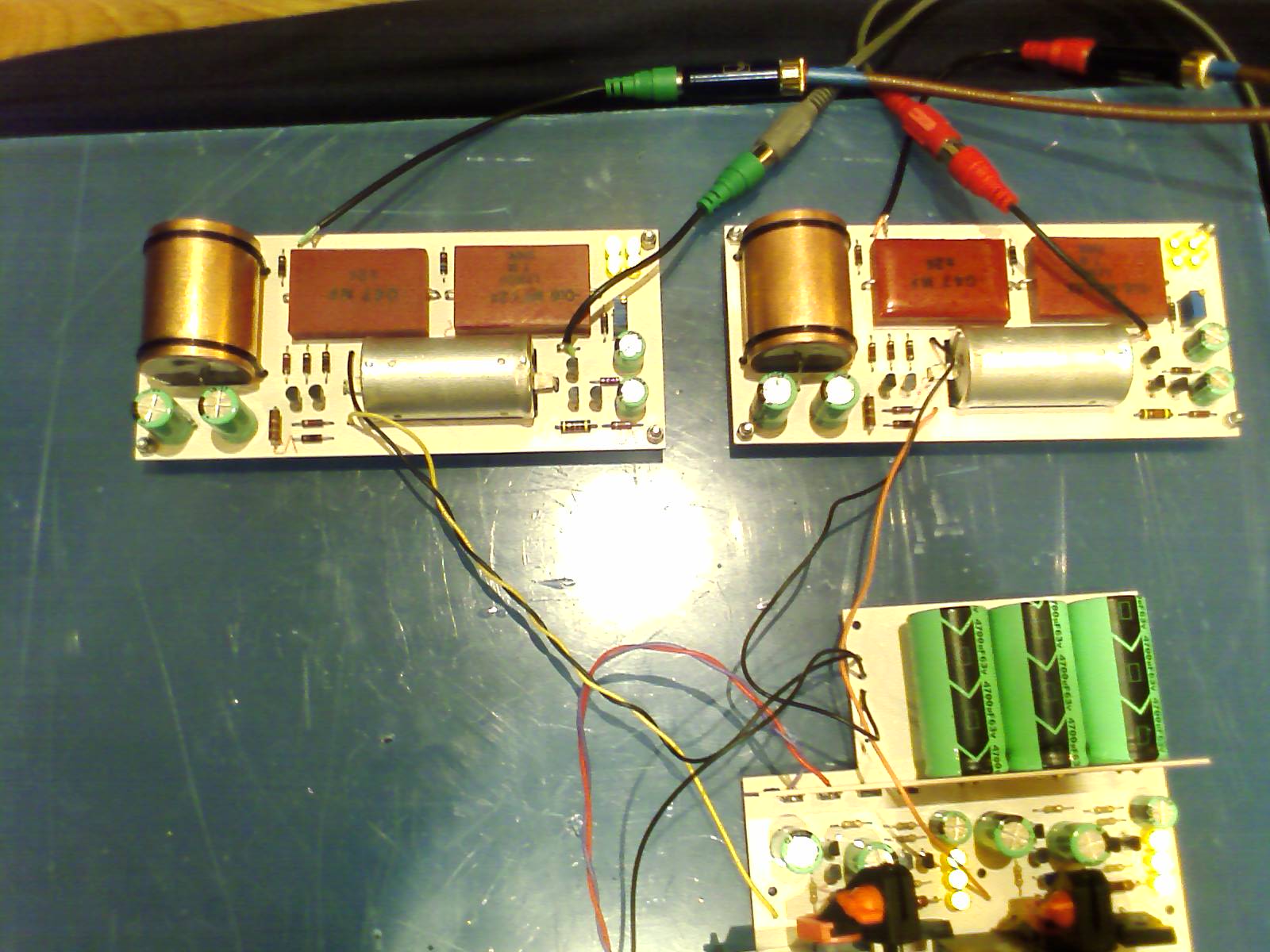

Probably I didn't make my self clear ( sorry Salas), When I removed Q3 I just want to remove it, and also Q1 from the signal path, so I listen to it with Q6 and led's working(only low level HUM), but of course no sound !
As you say, noise could come from Q3, and how about Q1?
I'm using four yellow led's, all the same ref, they give me Vref within the values (aprox 7.6V).
For the transformer, it's a R-core, 30cm away ( already tried 80 to 90cm).
I changed to a new ref led's and move them near Q3, installed a 33R base stopper, but noise is still there.🙁🙁
P.S.Right now I'm typing this and listening the phono, and sounds AMAZING ( except between tracks at medium volume)🙂
