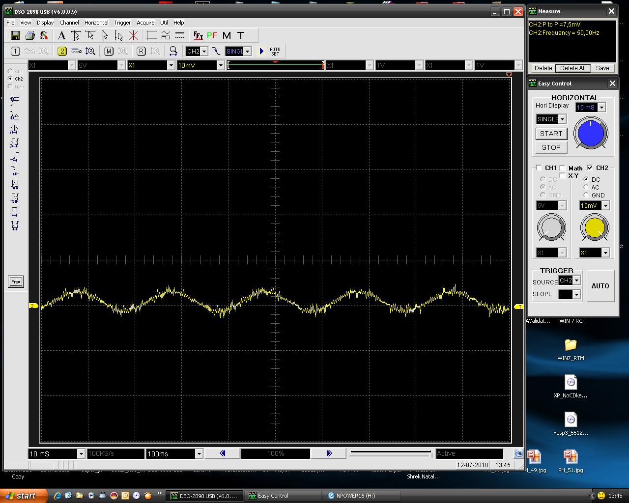

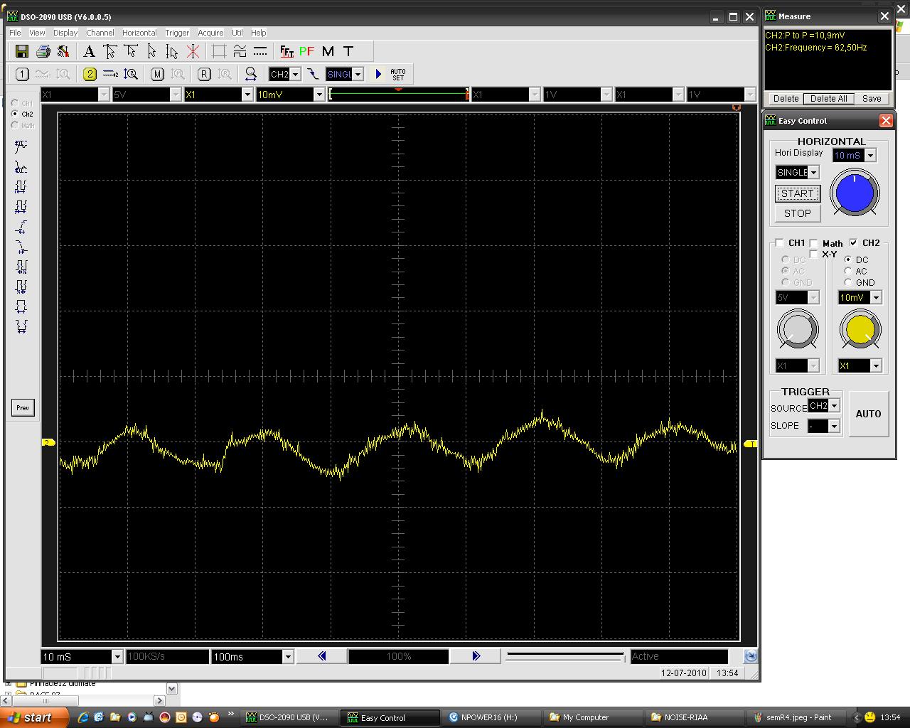

Hello, today I get some spare time and I did some mod on phono PCB.
1º I tried a new reroute on IN and Rload ground (acc to Massimo)-same problem!!
2º I switch to old schematic (C1//D1-D4; R17 replaced by wire; Voltage on Q3 adjusted to 10V)-same problem!!
3º I removed all the protective varnish from the PCB-same problem
4º Put the pcb inside of a aluminium box-same problem.
After step one I took some measures.
Vcc-38.3V
Q1 D-6.75V G-0V S-0.156V Idss-9.15mA
Q3 C-10.25V B-7.4V E-6.75V
Q6 D-38.3V G-7.4V S-7.62V Idss-6.65mA
Q2 D-8.62V G-0V S-0.128V Idss-8.55mA
Q5 D-20.53 G-8.62V S-8.75V Idss-9.45mA
Also you can see some osciloscope pictures on Cout
First with PSu shunt reg, normal config
Second with R3 pulled from circuit
Any idea ???🙁🙁

Those are hum frequencies. Is it wired for signal input and output with coaxial? Also take out the 220uf over the leds and see if it has anything to do. If there is 0.1uf across B+ on phono take that out too.
Yes , it's wired, both with coaxial.Already removed 0.1uf across B+ and no change. About the pictures , when I connect the pre to amplifier with R3 pulled from circuit ( figure on right with 7.5mV stable sine ) I get HUM on the speakers with a much lower level. But, when I put it back,(R3).the output raises to aprox 11mV and becomes very erratic, mean, frequency,amplitude and shape of the wave are always changing. At that time is no more HUM, it's more noise (can't hear the HUM). Looks like the noise comes from Q1/Q3 themselfs. Tomorrow I will try without C1. Could be some problem with the jfets, I bought them from a guy in eBay/Taiwan.
R3 disconnects the first stage if you take it out. So it comes from first stage.The voltages you posted are pretty OK.
