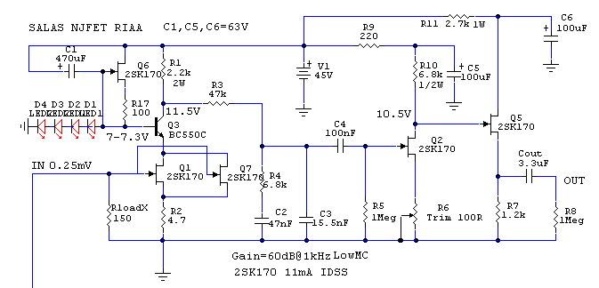

I measured my 100 pieces 2SK170V with 10VDC and 100R resistor.
Result:
9-10 mA 8 pcs.
10-11 mA 25 pcs.
11-12 mA 24 pcs.
12-13 mA 18 pcs.
13-14 mA 18 pcs.
14-15 mA 7 pcs.
So, I have no chance to build the 15mA Version of this circuit.
Which circuit version would you recommend to obtain 60dB gain?
I would prefer to go with 10 to 12mA, looking at the available numbers.

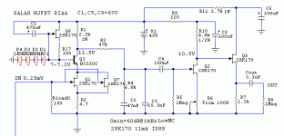

Its the way they interact with the rest. The target Lipshitz is the same. Resistor values change with different IDSS tunings and create a new total filter transfer function, so I compensate C3. For 100uF change, R9 is larger here for instance, so Q2 need not run more current to bias circa 10V, hence C5 is enough RC.
P.S. Due to tolerances of all components, C3 is advised to be trimmed by ear in each individual system by preference.

Many thanks for your 11mA IDDS / 60dB gain simulation. It is very helpful, as I dont have the simulation software and all the needed knowledge behind it.
I will follow this path now, as I have all the needed parts.

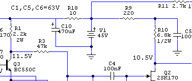

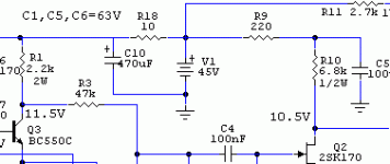

I started the layout of my pcb.
The complete stereo circuit:
Franz
R1, 101 must be 1.3K. Made by 3 pieces 3K9 1W in parallel in the 15mA IDSS first circuit you asked. Its a single 2K2 2W in the 11mA circuit. R12,C9a,b Would be more useful if not feeding the whole, but reserved for first stage so it cuts interaction, the other stages have already.
