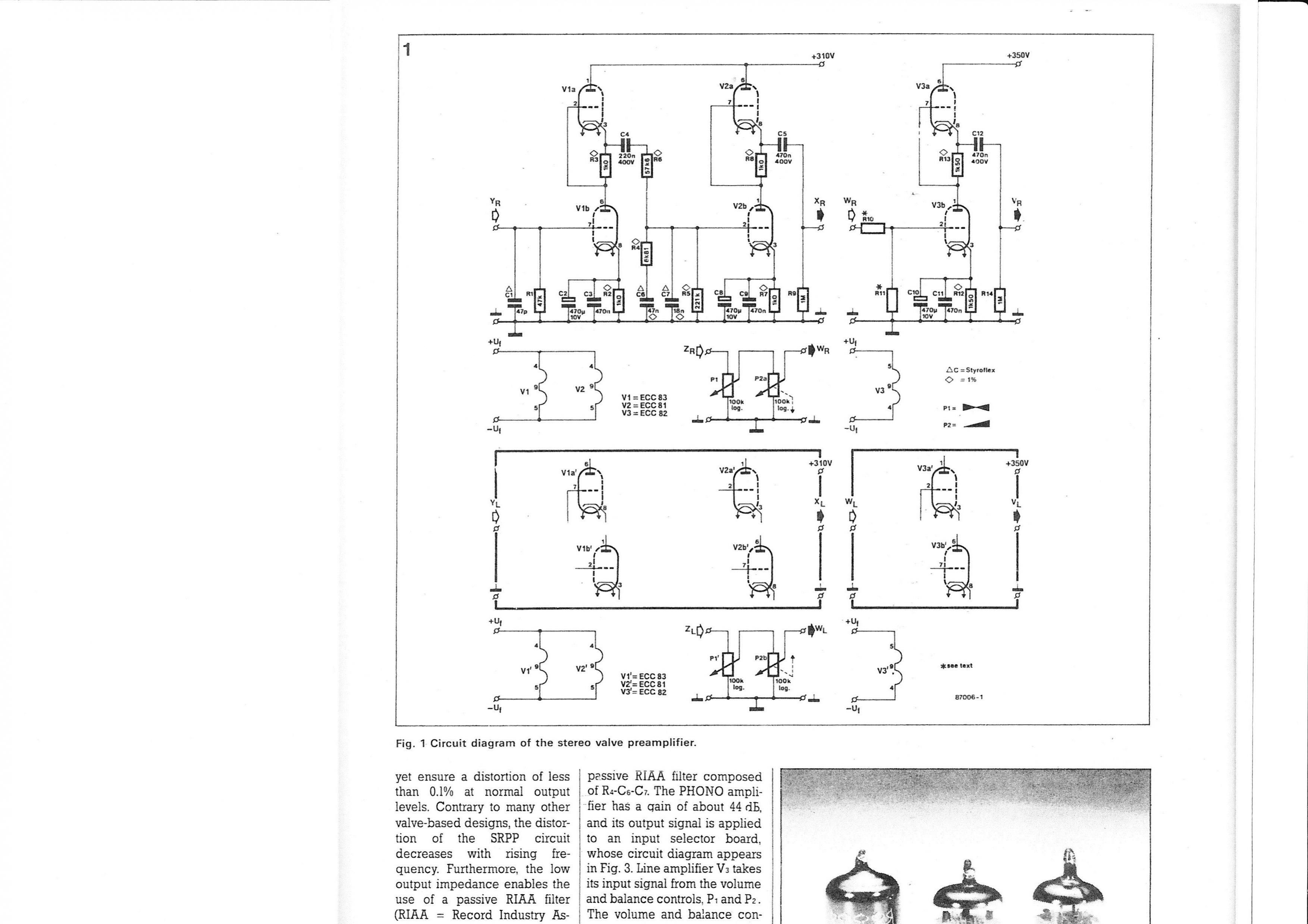

I built this in 1990. Iam getting some extra fets for a Salas RIAA. I also like to try the Allen wright design all tube
Tubes we have checked out many through the years. Including Allen's and Steve Bench's. For those I developed the SSHV originally. 🙂
P.S. I did one too http://www.diyaudio.com/forums/analogue-source/140635-valve-itch-phono.html
The Itch and the Bench. The Itch was made by listening to the Bench and the Simplistic. The Bench managed after I measured its Riaa transfer function and changed a key value. Without the SSHV PSU was less than the Itch. Kofi Annan made it with SSHV and the Riaa mod. Had a thread here. I have given the Itch to a friend who had the Thorsten grid leak and did not get to apply an SSHV to it so to know how it goes with it. He does not give it back for experiment, he listens to vinyl every day! But I will grab it one time!
