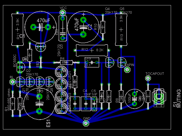

Hi Guys,
PCB with suggestions of massimo. Maxpou
If you do it as per massimo 1st suggestion I assure that will works perfectly.

Hi Guys,
OK, next step "star power". I mean from V+ input, one track for each gain stage..... 😉
