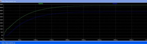

So I do not understand: With the 100V clamping zener, the simulation shows the differential voltage (Vds) at just...100V. So why is this a problem?
With this in place, the device never sees more than 100 volts difference from drain to source. See attached screenshot - green trace is input, blue trace is output.
Please explain, as it is not clear - I thought that's what the purpose of the zener was.

Its no problem, that is the idea, to keep the Vds in bounds during start up. Maybe the Zener junction capacitance gave problems in conjunction with layout inductance on a board attempt. That situation I did not experience personally with p2p. The BJT driver (error amp) of the shunt IRF840 current element has to meet your 400V spec also.

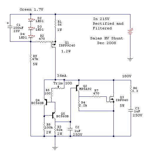

I am using the SSHV for a tube-preamp. Schematic as attached. The reg is in the my "signal" chassis while the powersupply is external. The wire between the two chassis is about 1m long. Would it be beneficial to decouple the supply with a capasitor to ground right at the inpt of the SSHV printboard?

Yes, it can be highly beneficial, it is recommended. A film capacitor between 0.1u to 1u should do it. In any case, it will do no harm.
If I put a choke between the shunt regulator & the anode tube, will be the same?
Anything (other than plain wire) you will put after the shunt regulator will result in higher Zo. For one, there is no need to put anything after the shunt regulator. Second, anything you may put after the shunt regulator can only degrade it's action and benefits.
There is a point, though, to take care of a very good filtering before the shunt regulator. CLC, or LC are good options, though CRC or CRCRC are good as well. Probably CLC or LC or CLCRC or LCRC are best.
