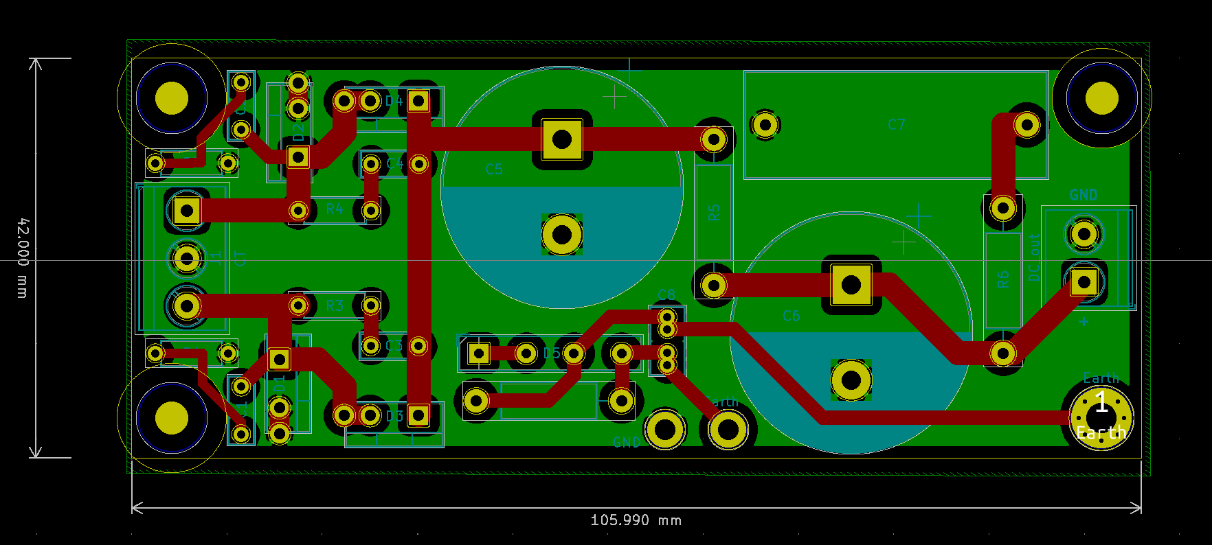

I had an SSHV2 regulator go thump in the night, and i am totally at a loss as to why. I found Q6 (2SK117GR) and Q5 (KSA1381) were both dead from the + side of the voltage regulator. Replaced both parts and everything is working again. My question is what conditions could cause a failure of those two components?
In troubleshooting always look at the last thing changed right?
I changed the main power transformer earlier that day. The regulator has run for the last few months with a 200v B+, current set to 25ma, and an output of 150v into a load of 3-4ma.
With the new setup i have 230v B+, current set to 30ma, and an output of 160v into a load of 3-4ma. Plan to eventually dial it up to 175-185v.
A small change, and all well within the limits of the components and heat dissipation. Q3 is bolted to the heat sink of a 2U Modushop enclosure, Q1 has a taller 50mm heat sink, and both Q4 & Q5 have small heat sinks attached to them. All overkill for the application.
I just need to figure out why it failed, as it ran for 4-5 hours before it failed, and only one of the two went. Any ideas?
Solid state parts are sensitive to HV transients. The DN2540s for instance are notoriously sensitive to stray inductance that can exacerbate transients. Not tolerating fast spikes above their max VDS spec. It can happen to a degree for the rest of parts too.
The new transformer maybe has less output impedance than the one's everything was running smoothly with for months of operation. So the turn on transient maybe got stronger. Semis can be shot gradually from transient strain also, not always instantly blown.
In any case you can replace Z3 with a Schottky diode for faster tighter threshold reaction and also put a series RC like 0.1uF 400V film 10R 2W across the raw DC input connector.
When you talk about transients, do you mean the sudden application of B+ power, or the application of a load?
New transformer does have lower impedance as its larger, something like 60ohms vs 82ohms for the old. Both are have 170v secondarys, filter section is a basic 270uf-10H(250r)-270uf.
I also use a delay start for the HV supply to give the filaments a head start, so the load should be there as soon as power is applied to the regulators, therefore the B+ isn't peaking at a higher voltage waiting for the tubes to warm up. The SSHV2 board is supplying one of Ales Gyrators boards for a 01a tube.
I should have the parts for the input RC so will try that. I don't follow what you mean by Z3?
Thanks for the help!
I meant the HV power on cycle. Raw DC section peak 'n all.
The third Zener, the one situated near the 2SK117GR JFET.
