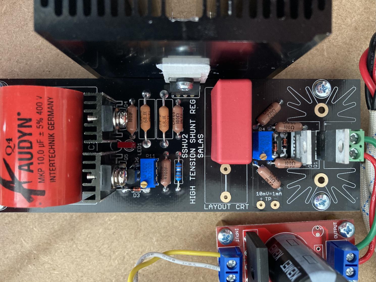

So I fired it up today and everything works, but I have a couple of questions:
1. I use 80x60x20(8mm base) heatsink, Vin is 335 and Vout is 310 and the heatsink is probably 65-70C (can hold my hand for 5sec most, battery is dead in the thermometer sorry). So I guess bigger heatsink is a must.
2. Current setting. When the regulated is powering the device, what TP readings would show, the drain by the preamp?
Before swapping the regulator I measured how much current the preamp uses and it way 15mA per channel, so 30mA in total. @300V it gave me 10K 10W resistor. I used that resistor to set up 600mV at the test points(just to have some extra room). The resistor was super hot btw. Now when I measure at the TP I read 410mV, and the preamp draws ~18.5mA, but I also changed input tubes: 6SN7->6SL7 to get more gain.

The heatsink seems rather small indeed.
The T.P. reading indicates the CCS current you set. The total mA available before current limiting kicks in. It does not measure what part is going to the load. You should had set 50mA (500mV TP) in the first case. Be conservative with spare. 10mA less is 3W less at 300V. The 410mV indication shows 41mA current limit. For 18.5mA load (total for two channels) 41mA is reasonable.

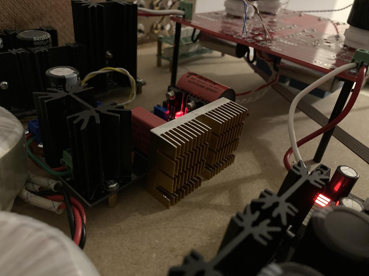

I got bigger heatsink for Q3, its temperature seems fine now. When the trim pot is fully "open" I get 800mV reading at the TP and it goes down to 520mV after Q1 and Q2 are fully warm. They are warm, not hot for sure. All the transistors are from the GB, so I did not measure Vgs, assuming they should be good.
Actually I take it back, even with my pretty big heatsink the temperature of the Q3 on it is way to hot after 40mins, I'd say 70+.. Q1 and Q2 are slightly warm and the TP shows 560mV maxing out the trim. Aikido is plugged and consuming 19mV per channel @ 310V
Measure Vgs for Q1 and Q2 when in circuit and powered on.
Q1's Vgs is Q2's voltage envelope. They should be good parts, but possibly at odds for individual Vgs, maybe mutually swap them to see if the CCS adjust range could get wider and more stable to warm up.
Just to make sure as I found in a data sheet G and S are left and right pins. So on Q1 it starts at 2V and drops rapidly to 1.1V and Q2 starts at 1.2V and drops to 1V. I would not wait longer as Q1 was without a heatsink as it is the only way I could get to pins and measure.

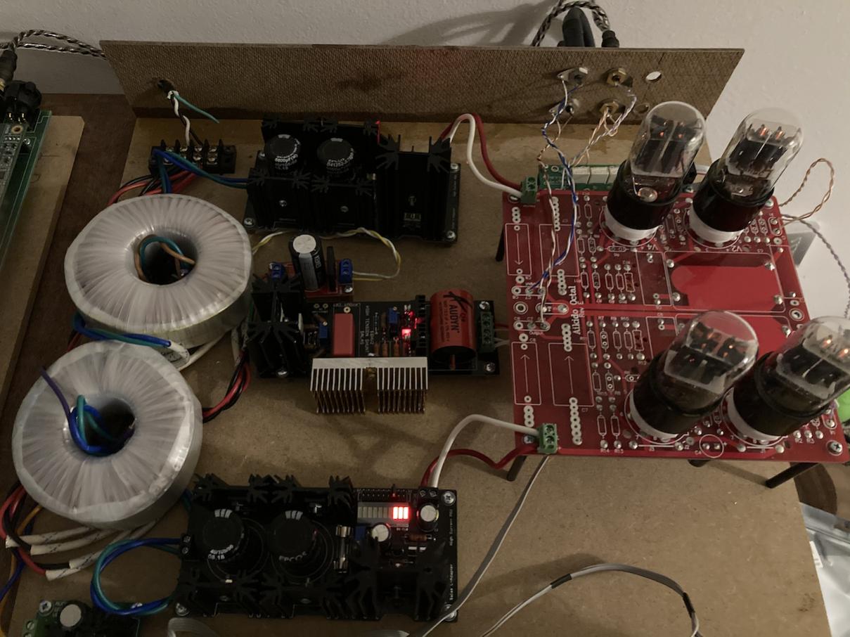

Big picture, just in case I am missing smth...
That explains it. If Vgs Q1 stayed, Q2 would have more voltage envelope and the cold CCS mA setting would be nearer to the warm setting. Maybe Vin (Raw DC) drops enough and Q1 conducts less? How much Vin - Vout DC difference is there across the regulator when cold vs when everything has warmed up? When using the Q1's sink as well.
So looks like something went wrong. I am measuring raw DC Vin and it drops from 340V to 280V as soon as I plug the regulator. It happens regardless of what's is connected after preamp or resistor. Any ideas what can it be?
Sag in your raw DC arrangement? Examples like marginal transformer's secondary AC voltage for the purpose, lower PIV than adequate bridge that lost an internal element, too small a filter cap? Can't give the demanded constant current mA while staying put for some reason.
If that wasn't happening before maybe a problematic MOSFET in the reg? Static electricity can punch them while simply handled or soldered sometimes. Does Q3 show healthy 3-4V Vgs?
50VA@240V secondary, 1000V bridge 100uf 450V cap, gives 360V with no load. Q3 Vgs -- 3.5V. I usually pretty careful and dont think I ever statically killed any semiconductor before, but there is always a first time 🙂. Can you check them in the circuit?
So you right, raw DC sags, with getting the current up. at 300mV at TP it seats at 320V at 500mV at drops to 310V, if I crank it up more it drops to 290V. I am confused with 50VA you supposed to have around 200mA at that voltage.
