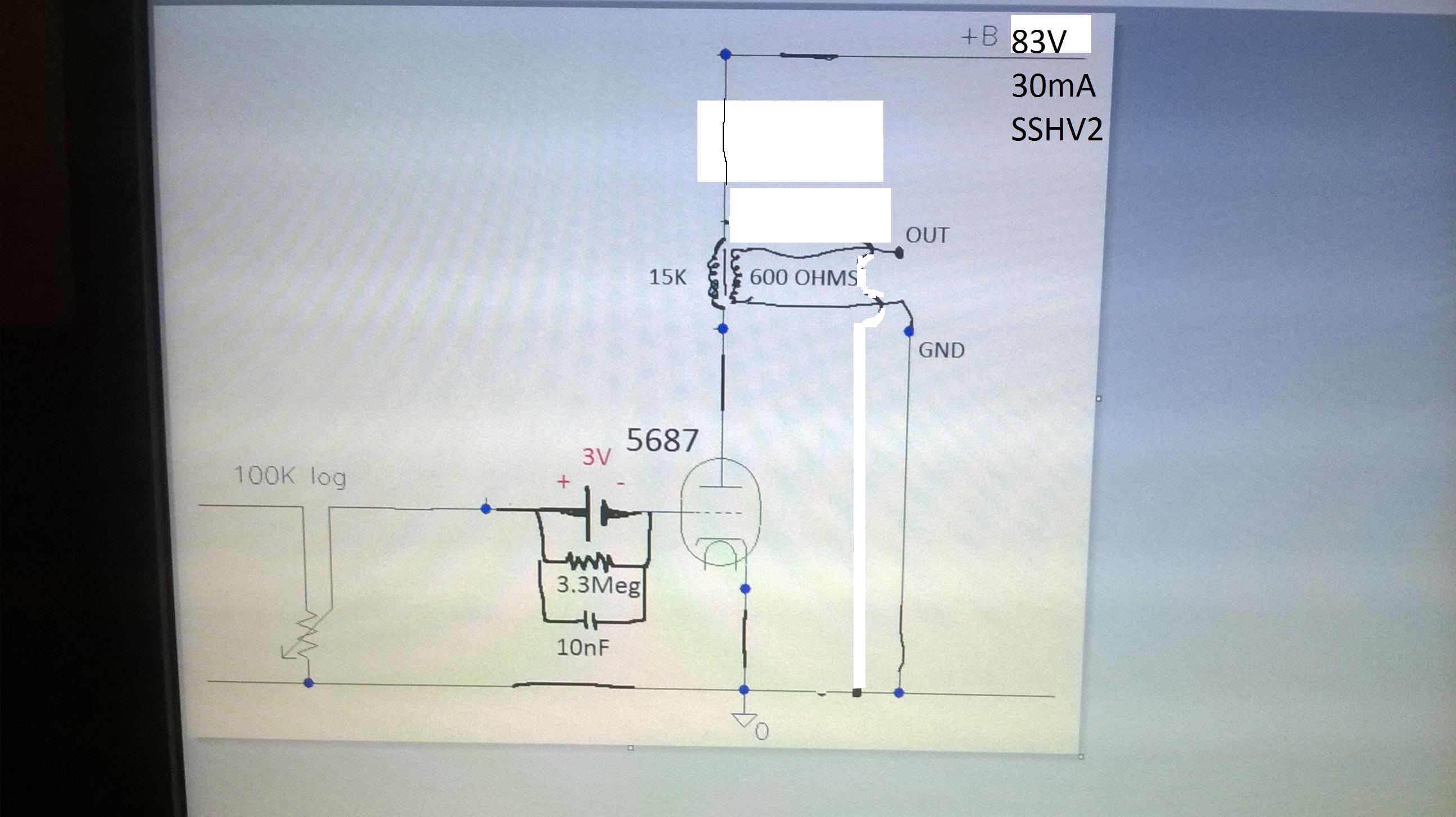

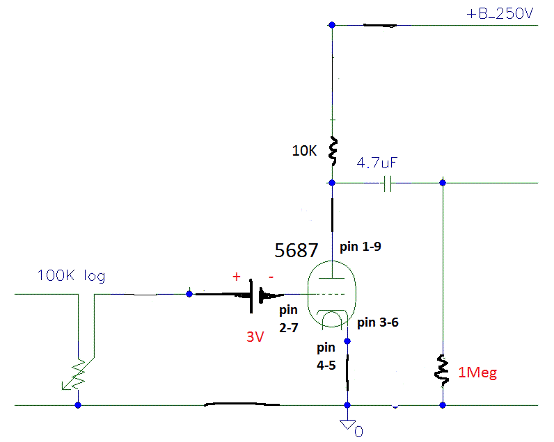

I have a question: I changed the 10K anode load resistor for 15k 600 ohms OPT to use as headphone the attached schematic, do you know how to calculate the new B+ value using the opt?
