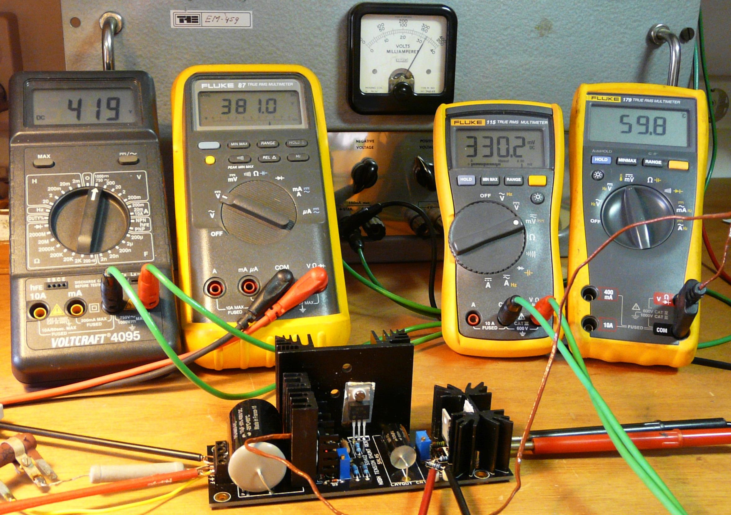

I tested your suggested settings, but choose somewhat lower values: mains fluctuation +/-3%. ((380+15)/0.97)*1.03=420V and a shunt current of 13mA. DC after filtering will be less then 1V p-p.
Here is what I get:
Meters from left to right:
Voltage IN (V)
Voltage Out (V)
Voltage TP (mV)
Temperature KSA1381, Q5 (°C)
I added more heatsinks to Q4 and Q5. Do you think 60°C is acceptable?

60°C is OK. I'm sorry I definitely missed something. Why do you measure the temperature on Q4 and Q5? The counting was for Q1+Q2 (CCS) and for Q6 (shunt). Power dissipation for Q4 and Q5 mainly depends on the output voltage and differs not very much.I added more heatsinks to Q4 and Q5. Do you think 60°C is acceptable?
Ah, yes. I experience no heat at all for Q1 and Q2 nor for Q3. These heatsinks are almost cold. In my case the heat is mainly produced by Q4 and Q5. That is why I added more heatsinks to them.
Is your R8 surely 1.8k? There should be about 4V VGS in Q3. If all is well then IQ4,Q5=VGS/1800=0.0022A (2.2mA). Dissipation Q4+Q5=381V*0.0022A=0.84W i.e. 0.84/2=0.42W for each one. Their sinks look rather big and the temperature still rather high. Check that those VGS and R8 values are correct.
Q1 should burn (419V-381V)*0.033A=1.254W in your picture. Can't be stone cold.
Q3 should burn 381V out * excessive shunt current available above load consumption. Expecting few W not cold.
Surely not 1,8k! I most certainly need a new pair of glasses! I am such a stupid cow, swapped R6 and R8! That explains a lot. Thanks Salas, for pointing this out.
Now I found that only 13mA for the regulator is not enough; not stable, too much voltage drift. When the current is set for the normal value (20 + 20mA), a total of 40mA, the heatsinks of Q1, Q4 and Q5 are about 35°C. Now the heatsink of Q3 is about 55°C.

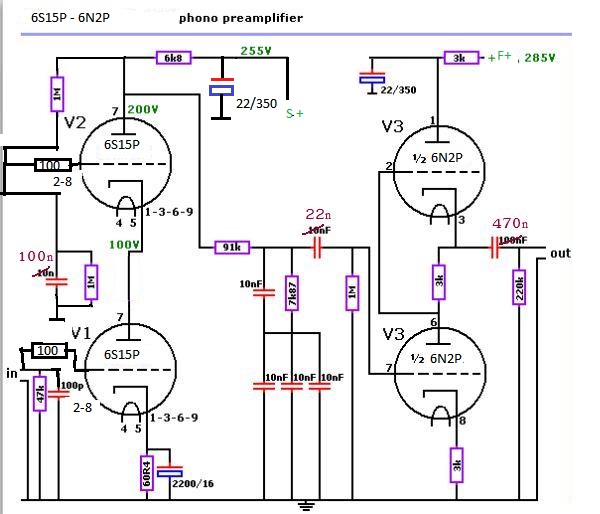

Hello friends.
Soon I will receive my pcb for the SSHV2 construction, and I want to implement it in my phono preamplifier.
As SSHV2 has double output, I would like for my 6S15P, S + output, which are more delicate and F + for the 6N2P.
Attached image. Is the S + and f + jacks correct on the phono?
The total consumption of the phono is 18ma, it is necessary to make some modification in the SSHV2 ?.
Thank you in advance for your help.

SSHV2 has not a double output, has a Kelvin output. S & F must meet at one same point. Use 38mA CCS setting in SSHV2. It has a trimmer and a test point for that. Read its pdf instructions file carefully.

By the way if you have space to install the SSHV2 near the preamp circuit so the cables can be not too long you can also use the classic two wire connection way. By shorting F+ with S+ and F0 with S0 using links at the regulator's output connector. Then each + and each 0 screw become a normal two wire terminal. B+/0. In that way and with thick enough cabling you have a simpler system against RFI or oscillations if you don't have an oscilloscope to know that the more complex Kelvin wiring mode is done screened well.
