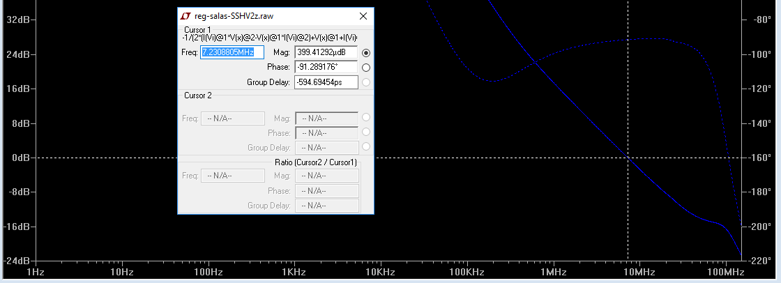

Tian open loop gain plotting method says ~90deg phase margin for standard SSHV2 and ~100 deg phase margin for SSLV1.1 (when with 4.7u 1R Zobel). Those figures should be generally plenty enough.I suspect it has insufficient stability margins when presented with a fast changing current demand.

Different parasitic inductance in the Zobel can change the phase shape enough

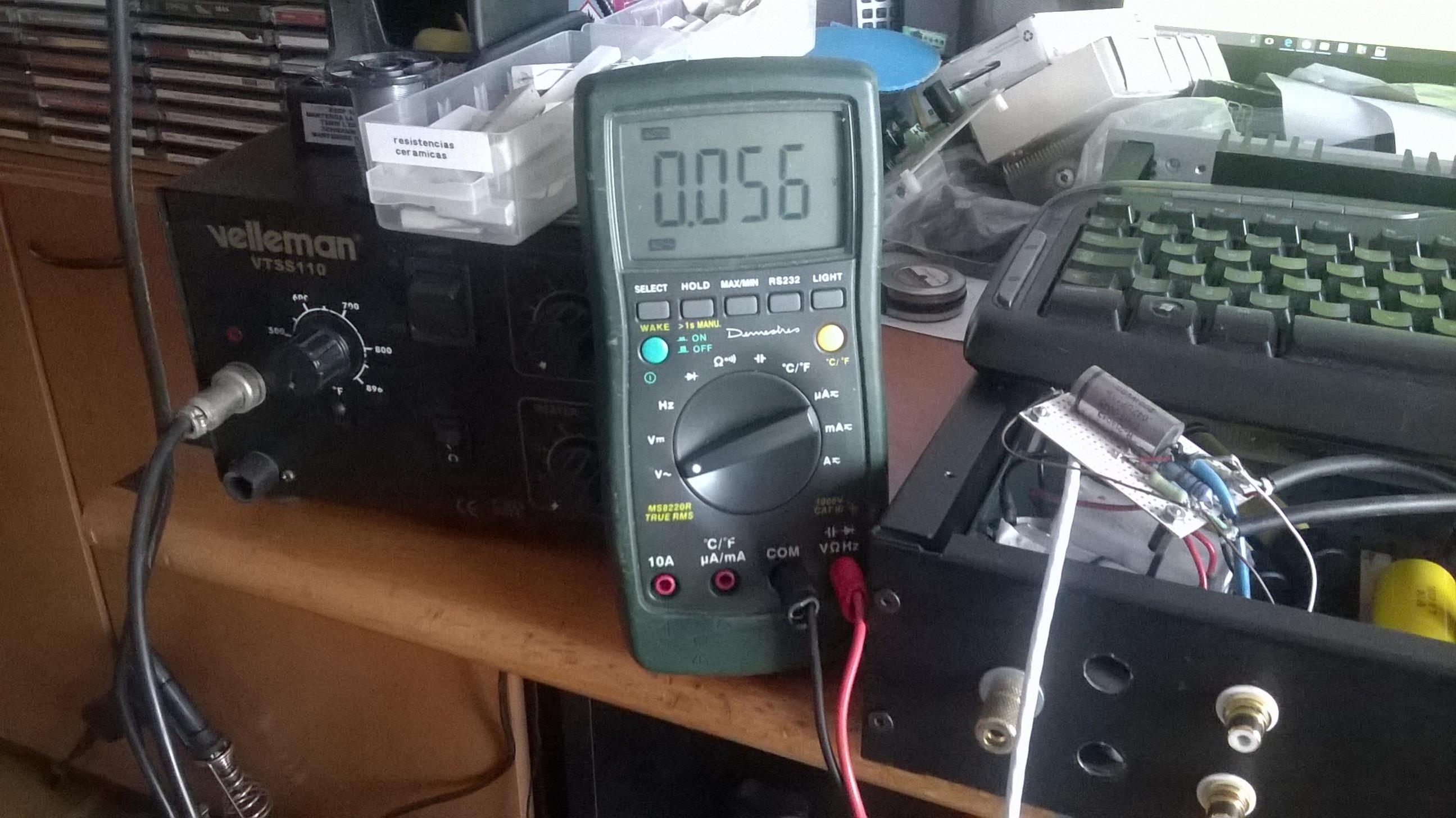

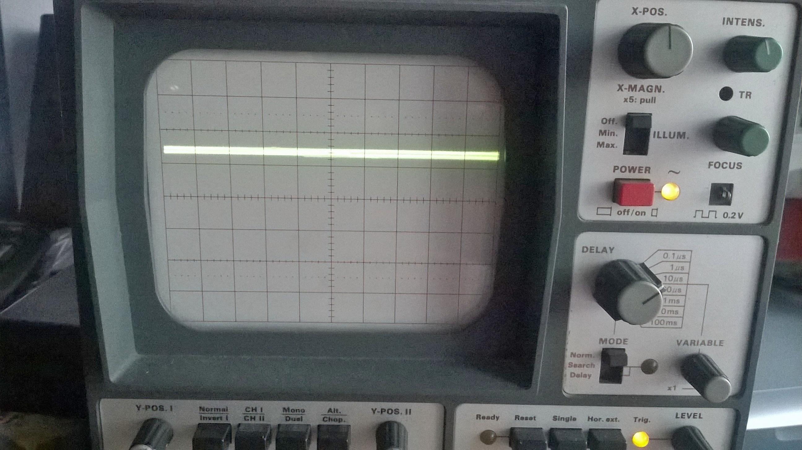

If it was oscillating it would be very high in frequency like MHZ. The DMM would be doubtful it could be sensitive enough to catch 56mV AC that high. When such oscillation its not in the scope, maybe its noise or some low frequency the DMM sees. Like hum. Sweep the timescale on the scope from end to end and if you can't also see it, its not verifiable.
