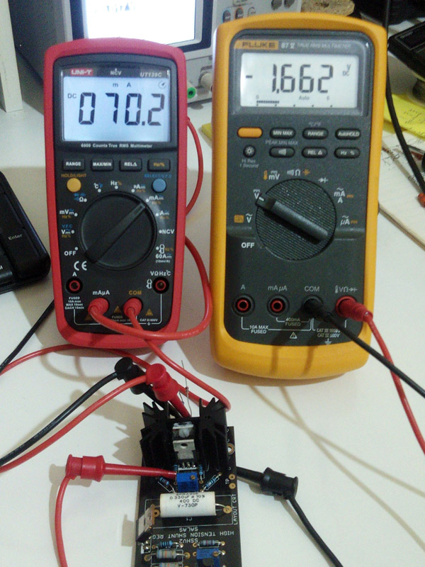

Just to be sure I did not forget anything - here is the simulation of the CCS part @ 70mA (the current which should be set according to the desired 50mA for the load).
The measurement at 70mA CCS current draw does not follow by large. It reads -1.66V for Q1 VGS & -1.58V for Q2 VGS. For non matched random DMOS.
It can mean many things: unreliable datasheet values, forged parts, wide margins for "good" parts... I checked the SPICE model for DN2540 and it seems close to the Output and Saturation curves, but greatly differs from Transfer Characteristic curves, which in reality close to your actual readings. So mistakes in the datasheet are not improbably.
The installed parts I measured are genuine from Mouser. In any case the Q1 VGS will be Q2's VDS and it should read equal or greater than Q2's VGS. For practical purposes when checking a possible CCS parts failure in this circuit anything well bellow 1.5V VGS is suspicious and the suspect DMOS should be lifted and checked for IDSS alone. Also the gate Zeners may be dead or compromised already and better be replaced with new ones or substituted with 1N400X diodes in same orientation. If the root failure condition is uncertain, for better stability the gate resistors can be changed to 1K value (makes slower CCS but still very good)It can mean many things: unreliable datasheet values, forged parts, wide margins for "good" parts... I checked the SPICE model for DN2540 and it seems close to the Output and Saturation curves, but greatly differs from Transfer Characteristic curves, which in reality close to your actual readings. So mistakes in the datasheet are not improbably.

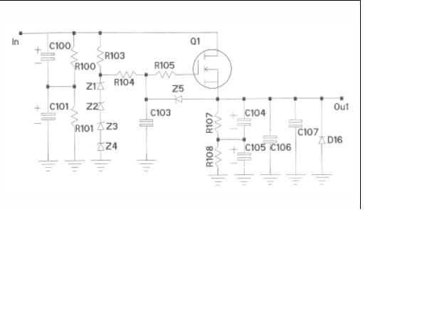

Dear Salas,
My friend has told me that the Welborne Labs PS3 acts like a very large reservoir in the power supply but not a "completely" and "high performing" regulator like the SSHV2.
I recently found the circuit of PS3 (see attachment)
Can we have a power supply build this way?
Full Wave Rectification (Cree Schottky Diode) --> 30uf --> PS3 --> 0.1uf --> SSHV2
Any comments? Do you recommended have a much larger cap instead of 0.1uf between the PS3 and SSHV2??
Thanks!

I would describe that circuit in the picture as a voltage referenced capacitance multiplier using a Mosfet. Your friend is correctly reading it.
Yes you could use that circuit as a pre-filter stage for SSHV2. Use 0.1uF as decoupler across SSHV2 input connector because there is already C106 // C107 as bypass output capacitance there. What are their values? Also Q1 will have to stand the voltage drop at SSHV2 current draw level so watch its sinking is adequate.
