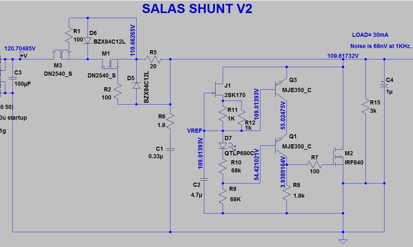

Hello to everybody.
Need someone help to help me solve the issue I am facing.
SSHV2 kit on breadboard 3kohm load with CCS set to 50mA.
Raw DC 120V 30ma needed on load.
The trouble is that I can change the CCS set but I am not able to go over 77-78V on the output (when I turn R11 voltage does not change). I made some checks according to the guidelines I found on this thread:
please see my image for see all V at pin off transistor
thanks

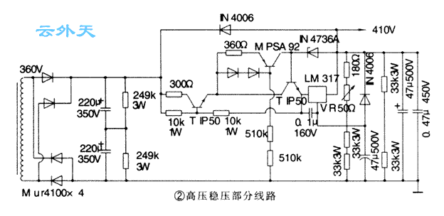

- the output impedance stability across all audio frequencies;Anyone able to tell me what area will be improved if the replacing the series regulator (attached) as shown with SSHV2?
- wider isolation from the mains AC (not only 50(60)Hz, but other wideband junks also);
- less noise;
- much easier choice of the filtering elements, particularly - capacitors and much faster power supply recovery after peak consumptions.
It depends on the actual circuit to power (completely agree with Salas in the area).Does the Salas drop more voltage and draw more current than this series type regulator?
IMHO, the answer is the same as in the previous question.What about sound?

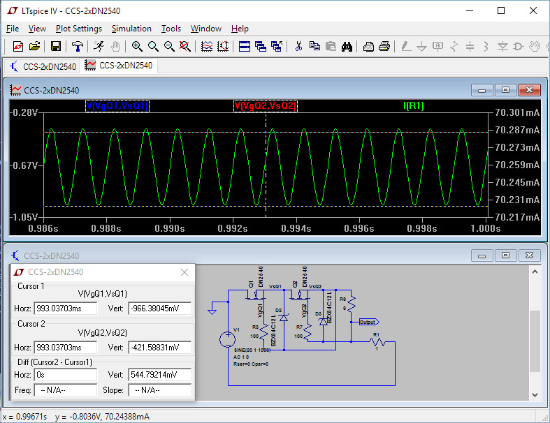

Why Vgs of Q1 cannot be 0.7V (by the way - how could the voltage be positive in the schematic at all?)? I think more reliable way of testing is the Vds which should change with the input voltage.
Because its a FET cascode and Q1 Vgs is Q2's VDS effectively so it can't be less than Q2's Vgs (2V he measured). It is (-) Vgs indeed in N type semis but we just usually refer to its value only.
Q2 is not a BJT, so Vds could be easily less than Vgs (see for example the Output Characteristics and the Saturation Characteristics of the DN2540 in the datasheet). Why the Vgs of Q2 is too big - is another question.Because its a FET cascode and Q1 Vgs is Q2's VDS effectively so it can't be less than Q2's Vgs (2V he measured). It is (-) Vgs indeed in N type semis but we just usually refer to its value only.
For Q2 to function properly as CCS i.e. past its ohmic region, VDS should be at least equal to |Vgs| and ideally >|2Vgs|
Q1 is shielding it in common gate mode providing its VGS(OFF) as VDS for Q2 and the DN2540 datasheet says min VGS(OFF) -1.5V so some Q1 with -0.7V is suspicious anyway
It greatly depends on the desired current and not so straightforward. For example, for the Id=20mA, Vgs=-1V and the saturation begins from around Vds>0,7V.For Q2 to function properly as CCS i.e. past its ohmic region, VDS should be at least equal to |Vgs| and ideally >|2Vgs|
Not at all. Vgs(OFF) defines the minimal voltage (taking into account a sign) @ some defined Vds (in our case =25V) when the current through the drain drops to a defined value (in our case = 10µA). -0.7V is greater thanQ1 is shielding it in common gate mode providing its VGS(OFF) as VDS for Q2 and the DN2540 datasheet says min VGS(OFF) -1.5V so some Q1 with -0.7V is suspicious anyway
-1.5V, then Q1 can conduct. It is Vgs=-2V for Q2 (so - below Vgs(OFF)) that worried me more. At that voltage Q2 should not conduct at all, but Ian said that it worked and even regulating current! For me the measurements are suspicious, not the -0.7V Vgs for Q1.

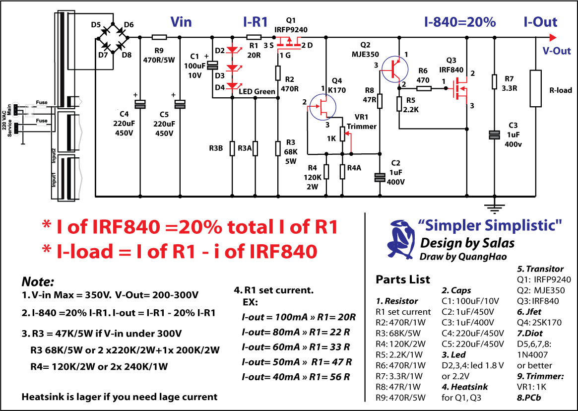

Dear Salas,
I am having trouble to understand the total power consumption of the circuit attached, and I might have underestimate the needs in ordering the transformer.
I set R1 to 47 ohm and I measure 2.3V across it.
I have 250V AC in input.
R3 is 56K.
The load is 30mA.
Output 270V.
Everything wonderful, but why am I pulling 118mA from the primary at 230V ?
Should it be like this or I have some oscillation somewhere ?
I had estimated a need of 70mA and now I am way short.

Then, the part to the right of R1 is taking 49mA. IncludingI set R1 to 47 ohm and I measure 2.3V across it.
Then:The load is 30mA.
The current is approximately 5-6mA.I have 250V AC in input.
R3 is 56K.
It's all that Salas' circuit consume. The rest is the losses in the rectifying and filtering. I'd lower the first capacitor considerably or add some resistance before the bridge.
How many R3 have you used?
R3=56k with 330Vdc will pull 5.9mA each. (check the power dissipation of this resistor? Do you need to use series connected resistors?)
R1=47r with 2.3Vdc will pull 49mA
Leakage through C4 & C5 should be <<1mAdc. Did you reform them (slowly) before assembly?
Total draw will be ~5.9xN + 49 + 0.1 mA
If N = 1 then total secondary current is 54mA and your secondary current rating should be >>108mAac
I would select >=200mAac
If N=3, then >=260mAac
Note, that output current draw does not enter any of the calculation.
That is the way CCS fed Shunt Regulators work.
