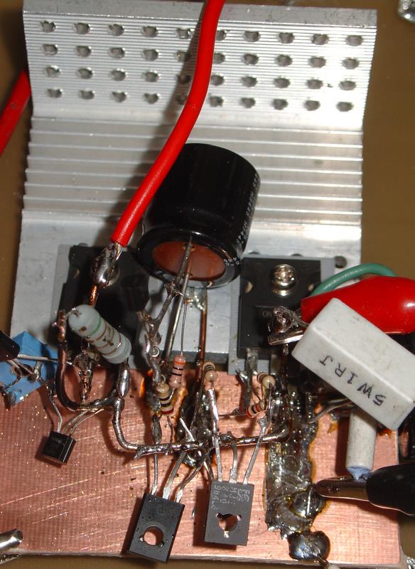

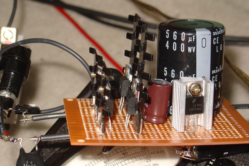

OK, so here's the prototype. I know, it's a mess.
First, the rectifier diodes + gyrator filter.
back
and front
the regulator top. Next to the left mosfet is the trimmer mounted on the dn2540 . Next to the dn2540 is the mpsa42. The big cap in between the mosfets is across the zeners which are hard to see in the mess in the middle. Those two TO-126 transistors in the middle are the mje350 and mje340. The big white 1R resistor is in series with the load, so I can keep an eye on the current.

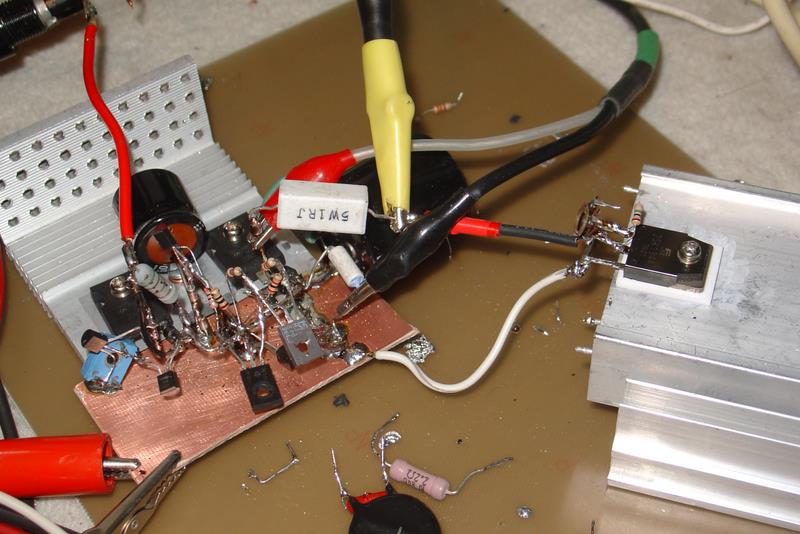

In this pic the load can be seen better. Below the large white resistor is a smaller 0R1, in series with the source of the shunt mosfet, which I'm using to monitor the shunt current. The load is a 2sk1944 900V mosfet, with a 1M across D-G, and a 100K variable resistor across G-S which I adjust for the current I want as load.
You know how zeners are not exactly the advertised value? I used two 75V zeners in series. Unless the Fluke is all wrong about the measured value.

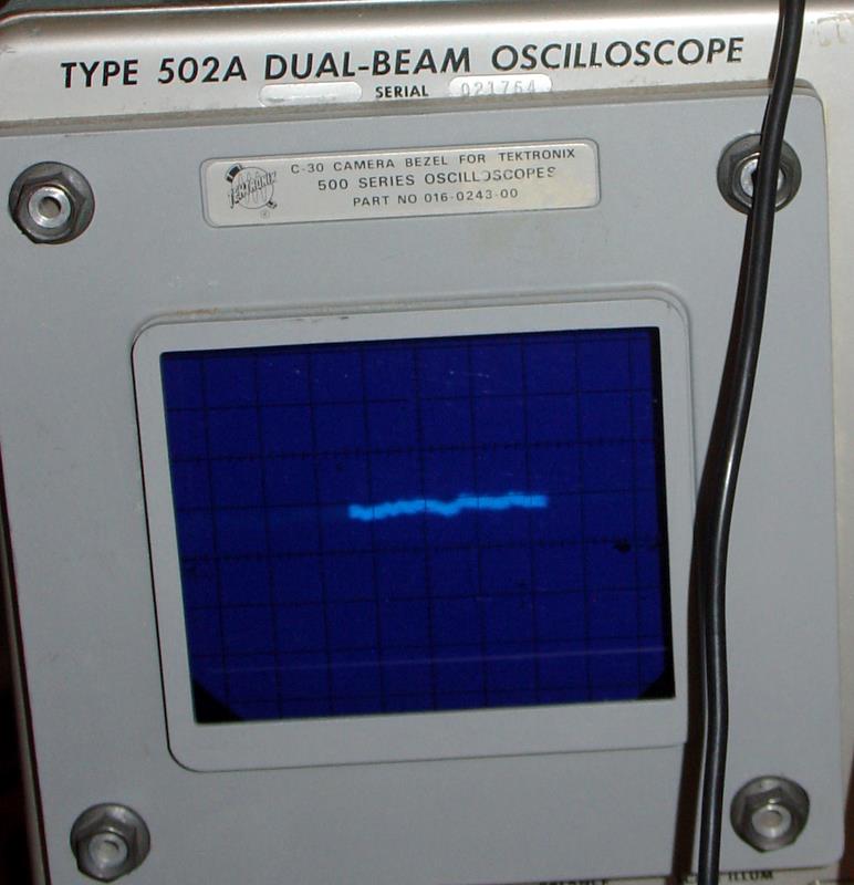

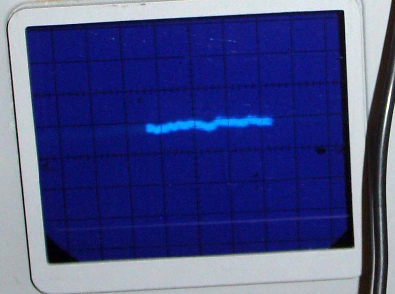

Now this was hard to catch with the camera. The scope was set on 500uV/div.

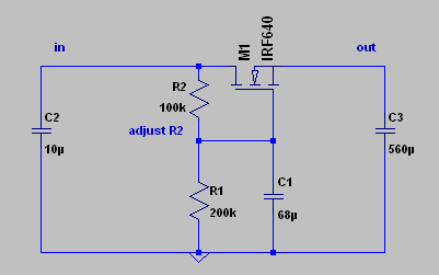

Iko,
Could you add the circuit that includes the gyrator - quite interested in these strange things, particularly when combined with Cmultipliers!
James, it's a very simple thing that I used, for lack of a good choke
R2 is adjustable, started with about 100R then increased the value until I got the voltage drop and filtering that I wanted.
Thanks Anatoliy, I love my tube tek 502a 😀 yup... what's not to like, real dual beam, 100uV/div sensitivity, dual differential input.

Excellent. I love dead bug construction. Smells genuine DIY. Keep C3 off the sink. You compromise it and you ware it out with heat. Good to use a Mosfet gyrator for a choke, best value for money and some delay. We had a thread with Anatoly about gyrator goodness for other purpose, as constant voltage anode load not too long before. The NTC to the far left of 2nd picture is a good soft start measure too.

There is some magic in building a new design, it reminds me of the time I used to develop B/W photos... when the image starts appearing on paper like a ghost. So no matter how messy it gets, I still like it, but I know it's not everyone's cup of tea. Yes, C3 is badly set on the sink, which is too small for this project anyway. I'll redo the circuit on perf board after some more tests, for the headphone amp, then it'll have a proper layout.
Good eyes, you spotted the NTC. In fact I use two of them, one on each secondary lead; 5D-11 is the component. I was afraid of the inrush current. Do you know anything about how an NTC might affect the sound?
My opinion is, gyrators here are suboptimal. Unlike choke, they can't store an energy. But what is drawn, is a R-C filter with a source follower, it is much better thingy here than a gyrator. Hyrator with the capacitor in series may be tuned on some frequency to form a LPF, but actually what is needed, a dynamic resistance on all frequencies, from zero to megaHertzs, as low as possible.
Anatoliy, you say that a choke is what you prefer in a filter?

It looks quite fine from my first sight, but I would limit base current of a current sensing transistor, and protected gates by Zeners: if MOSFET starts oscillating it may destruct gate insulation.
You mean a base resistor of 50-100R on Q2 and zeners on G-S pins?
Edit: well, I just modified the schematic using your suggestion. Thanks!

If in line with a mighty trafo in a large A/B amp they modulate a bit. But with constant current as with the shunt, no worries. They are blind to the load.
Anatoly is referring to ''punch through clamping'' as I have mentioned before. If you use 12V Zeners its about 3.5uV self noise they are going to put across G,S. Your call.

Gyrators or capacitance multipliers are a good and economic measure, not real chokes, but they could be overkill with the psrr our stuff attains. In general you hear what is before those shunts a lot less. And that saves $.
Yes, I thought about that too. But if the circuit has reached its operating point the voltage across G-S should be below the conduction point of the zener, so the only current going through it should be tiny (leakage), so the usual zener noise should not apply, right?
Theoretically yes, but I don't trust the little buggers.😀
P.S. Sometimes the jinx can go negative so they usually clamp them with 2 Zeners back to back or a Zener and a blocking diode.
