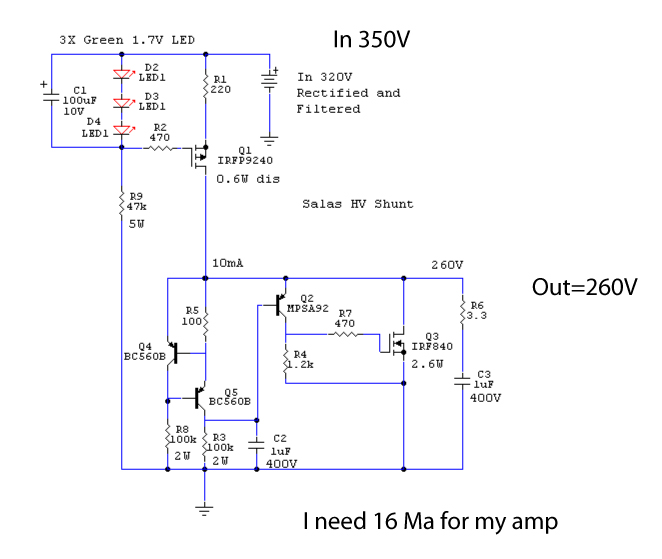

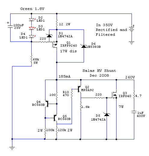

Salas said:Q2 has Vout-Iq2R4 across it and Vout-Vbe on its base. You can use MPSA94 for it also, and you can keep the shunt NMosfet as hotter on top the load consumption as you feel, only allow for dynamics. The more, the better.
I still don't understand how the constant current circuit Q4/Q5 can work if it only has Q2's Vbe (0.6v) across it. With a resistor of a kilohm or more between Q5 and the base of Q2 (as has already been suggested for HF stability) the circuit would work OK.
My other concern is for the well-being of Q5. Perhaps I misunderstand the circuit, but surely at switch-on C2 is close to a short circuit, which would put a large fraction of the regulated voltage across Q5? It's not clear to me that the shunt MOSFET would protect Q5 with 100% reliability. Perhaps this is the reason for the failure of some implementations of this circuit when Vreg is adjusted too quickly.

The ring of 2 obviously works, we would have no Vref if it did not.😎
1k res to the Q2 base compromises transient behavior though.

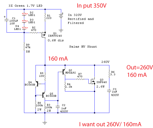

If you need 16mA as noted on the circuit, just make R1 82R 1/4W. In this case there will be 2.5W dissipation on Q1 and 4W on Q3 when 16mA is always drawn. Use sinks on both. With 100R for R5 it looks like giving 265V ballpark with 350V in. But because it normally drifts and stays lower, start with such a fixed resistor so to see if it will need anything different. Let me know when you make it and it is measured for Vout after 15mins supplying your (pre?)amp.
We did not have good feedback with an attempt at high mA from a member here in the past. Had burned components. Our experience is excellent sound and long time working builds around 100mA the most. Anyway, I have prepared for you a circuit with maybe better safety for your purpose. It runs at 185mA, there must be some headroom. It may work OK or it may fail.
The parts cost is cheap if you are willing to take the risk of testing.
You will need a 1C/W heatsink to mount the Mosfets, be sure they are insulated from it. Also don't try it without 160mA load, else the shunt Mosfet will need a very big heatsink for dissipating all the 185mA current alone. Takes practical care and no wrong moves at such voltage and current. Mount the 220R gate stoppers and 470R base stopper directly on the respective semiconductor inputs with short legs.
