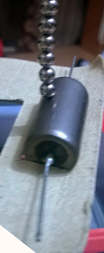

Is SSG = ccr in Russian? If yes I have some SSG-2 ones and they are definitely magnetic.

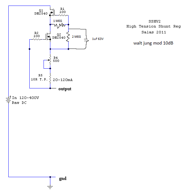

Well, here's a different thought: I'm wondering if anyone has tried the "bias multiplier" idea described by Walt Jung, in the CCS of Salas' regulator. see:
www.waltjung.org/PDFs/Sources_101_Letter_Revisit_0409.pdf
He claims a 10 dB noise improvement. It might only be worthwhile if you're using it for a MC phono preamp. Looks hard to fit it onto the PCB, flying parts off the board and all. anyone tried?

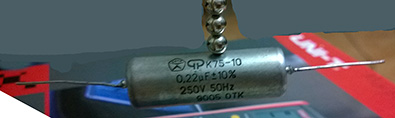

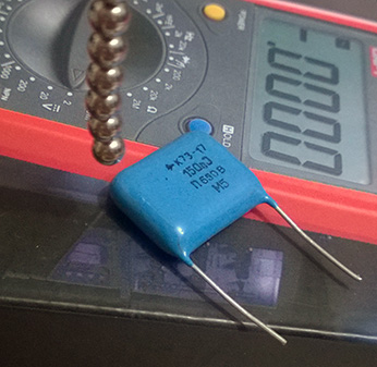

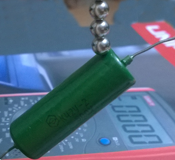

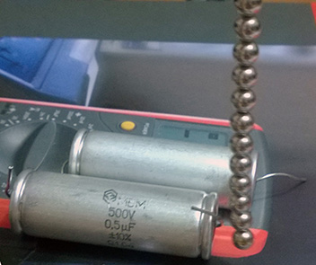

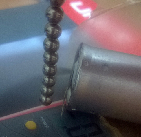

Yes, SSG=ССГ. I read you message too late, can't prove exactly SSG, but tested several other. (Sorry for off-topic - feel free to delete the message)Is SSG = ccr in Russian? If yes I have some SSG-2 ones and they are definitely magnetic.
Non-magnetic: FT-3, МБМ, К73-17.
Magnetic: К40У-9, К42У-2, К75-10.
I should mention that it is just a fun for me. Never take care about magnetic or not.

Could I try using attached pic?
Felipe, all I know is what you know by watching the Jung schematic. Just copy exactly. This is HV environment we got here also. Be careful, not sure what it can bring. One thing I can see is that the previous current set will probably go up, so check that right away.

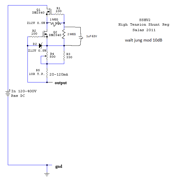

Merlin, it took me pretty long to see what was the difference between those schematics! more coffee.

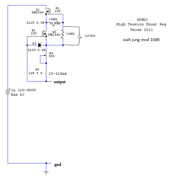

in fact they're not different, except one of them has all the current going through the adjustment trimmer. I'm not all that expert, but I expect it's fine as long as that trimmer is rated to handle it. With maybe a 3x safety margin?
You've also omitted the zener which is meant to protect against G-S breakdown. Jung's schematics don't show them. The device is cheap, I suppose. I'd probably put the 1 Meg in parallel with the 12v zener.

again, I can't say I'm an expert on the subject, but I think the voltage across the trimmer and the 10R test point is equal to the Vgs of Q2. actually I'm sure of that part. What I'm not sure of is if that Vgs would be different with this "bias multiplier" arrangement. I thought not...but I'm not certain. Without R3, I'd want to use a 1W trimmer.
Another thing to consider is that the minimum voltage across the whole CSS is a little higher, right? The "multiplying" going on is for Vds of Q2.
