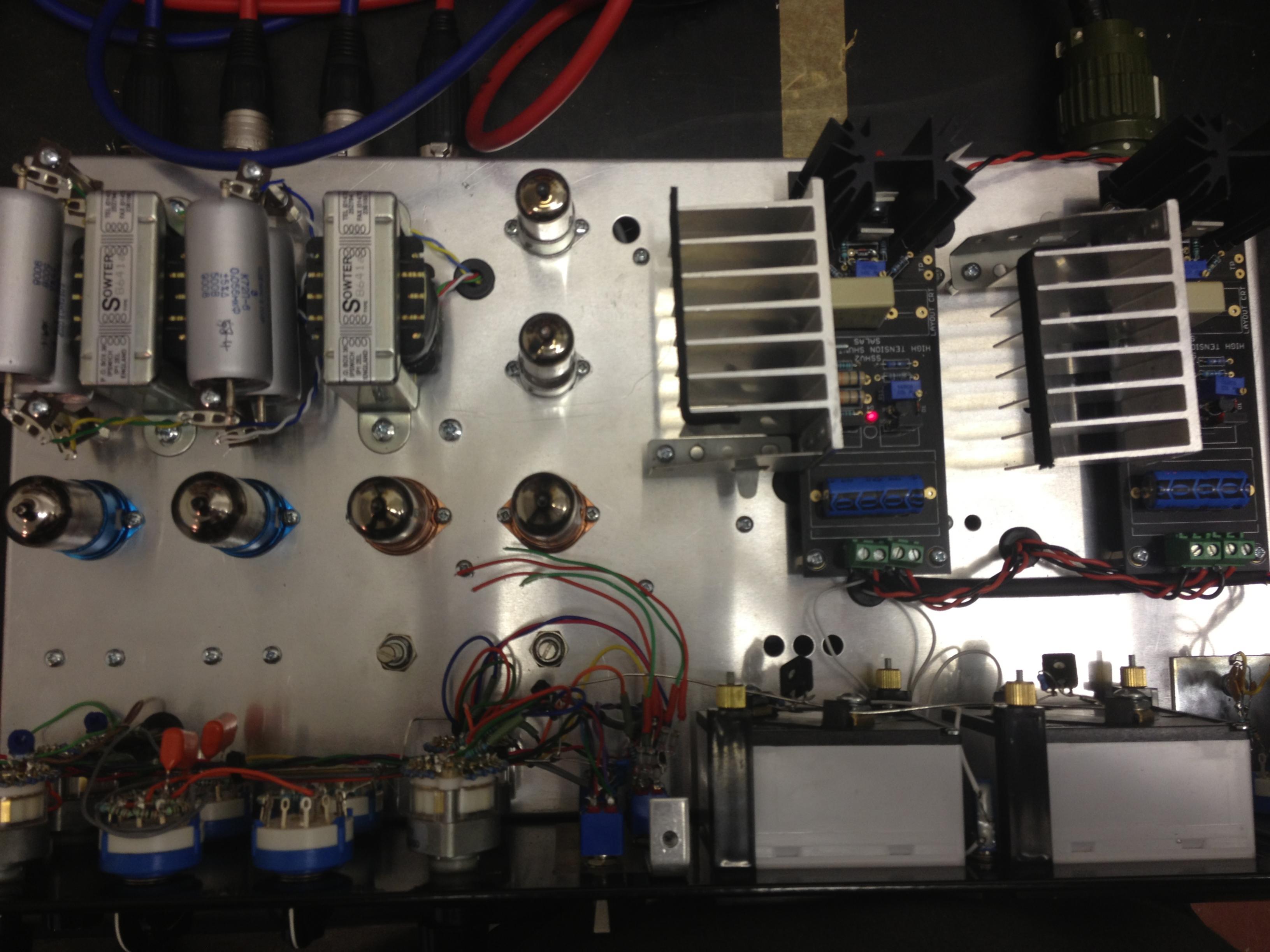

Almost done with my compressor, still trying to sort out the last instability issues at fast compression, but it's almost there. Last bits, just adding a SS/valve side chain switch.

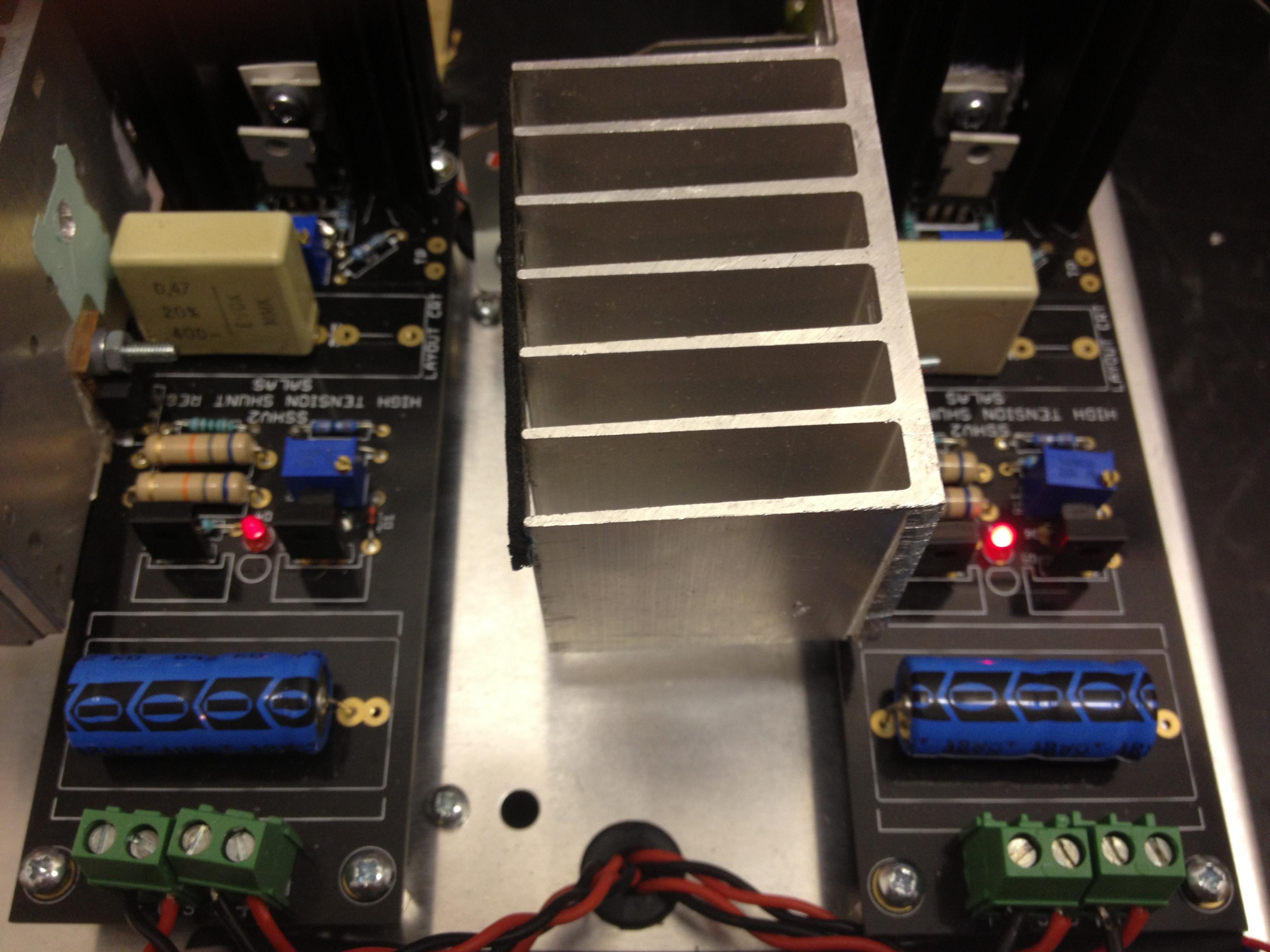

Promised some photos so here you go! It's going into Ocean Sound Studios in Alesund, Norway. New mix room being built there and this will be the first custom unit 🙂
One question - the LEDs on both boards are the same type but one shines brighter than the other, is this something to be concerned with? The boards are running very well, but thought i'd ask anyway.

For same output voltage there ought to be same current set via the Jfet sources that runs through the LED to the Vref 68K resistors. Therefore same type leds should shine about the same excluding some possible luminosity variation from sample to sample. Just because there are two circuits and two regs, try to scope if there is something different going on with sense points or there is some VHF oscillation in one that finds its way back and the higher brightness is a clue. Or the dimmer brightness for that matter.
I have tested all the points and they all read the same. My scope isn't great but it doesn't look like there is any VHF oscillation. Unless there is on both boards - it just looks like noise to me. About 2mV - is that about right for this reg?
If there is oscillation what might be the issue? A ground loop?

When on a rail AC coupled to a scope and seeing a straight line, then 2mV Pk-Pk thickness of random nature can be anything radiated in the total circuitry or picking environmentally by the test loop, it would not alert. If not seeing any waveforms riding then it should be stable. Is it the same display on the sense outlets on the regs themselves?
OK I understand. Yes the same display is on all sense points on both regs.
Going as close as I can with the scope there is a ripple of about 620KHz on both boards, but as you say - it may be something else I am picking up. There is certainly nothing on one board that is not present on the other.
